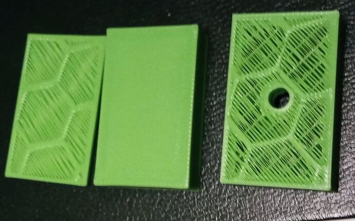

I’m trying to create an object with good strength and rigidity, but keep some “give” in the top surface, as this object will be screwed against a rough wall
I tried different approches, but none of those gave me the expected result :
  1. I created the object and added a modifier on the last upper 2 mm, to define a lower wall count and density, and remove the upper layer (top surface)
    this give me 2 different areas, as expected, but no solid layer between them both areas
  2. I split the object by creating 2 parts with the expected properties (same as using the modifier)
    if I print each part separately, I get the expected structures, bottom part with an upper layer, and upper part with a solid first layer
    but when I print the whole object, I loose any separation layer between the 2 parts, leaving the bottom part infill visible
  3. i tried exporting the assembly as one .stl file, but the result is only one set of settings
I seems that merging 2 parts in one object confuses the upper and lower surfaces settings of the parts, or I missed something.
Any one tried this and could share some advice ?
thanks in advance

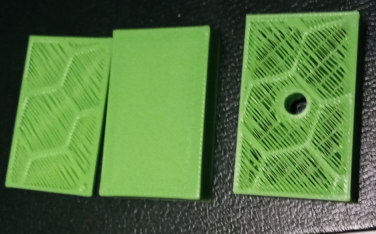

here is a picture showing :
  • on the left, the individual print of the 2 parts,
  • on the right the print of the object made by merging both parts : no intermediate layer, the bottom part infill patern is visible

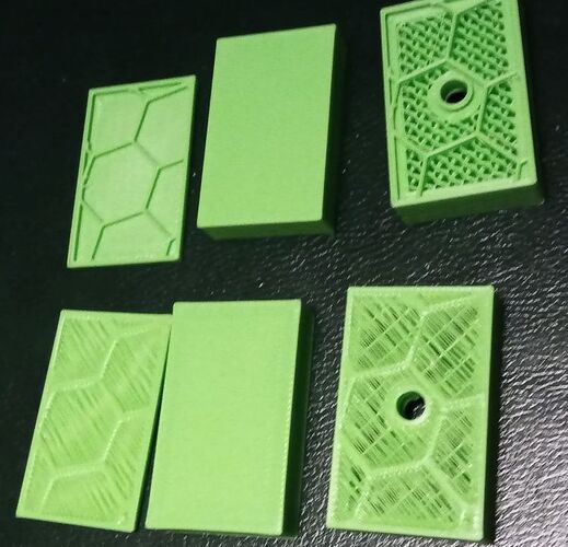

I also noticed that the prints from Bambu Studio (bottom of the picture) have a partial top layer, while the same objects printed on the same printer using Orca (upper row) don’t have this unexpected upper layer
answering myself for reference if some one is looking for the same :
single object with modifier is the way to go, with the followinfill %ng options :
  • no top layer (thick =0mm, 0 top layer)
  • infill % 25%, patern : giroid (or any other patern you like)
  • insert solid layer” parameter set to the layer(s) you want to create the flat area
  • modifer for the upper part of the object , with lower density fill in (and patern if you want)
