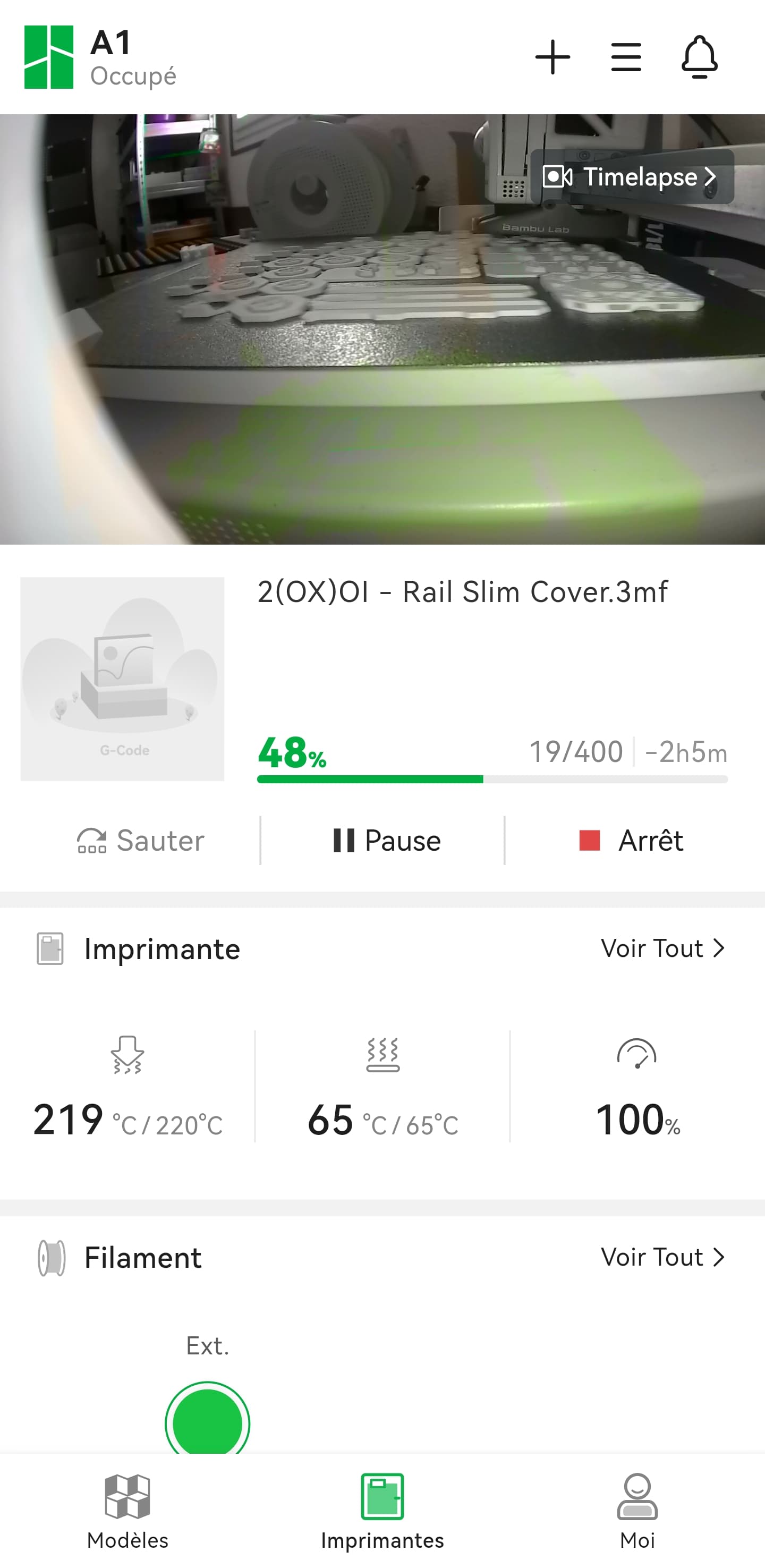

Just updated my A1 today and was checking to see how the print I am running was looking.
Noticed this very bizzare artifact on the screen. There is nothing red in the surrounding area that could be casting a reflection and the artifact is static on the screen.
Anyone else having similar issues.

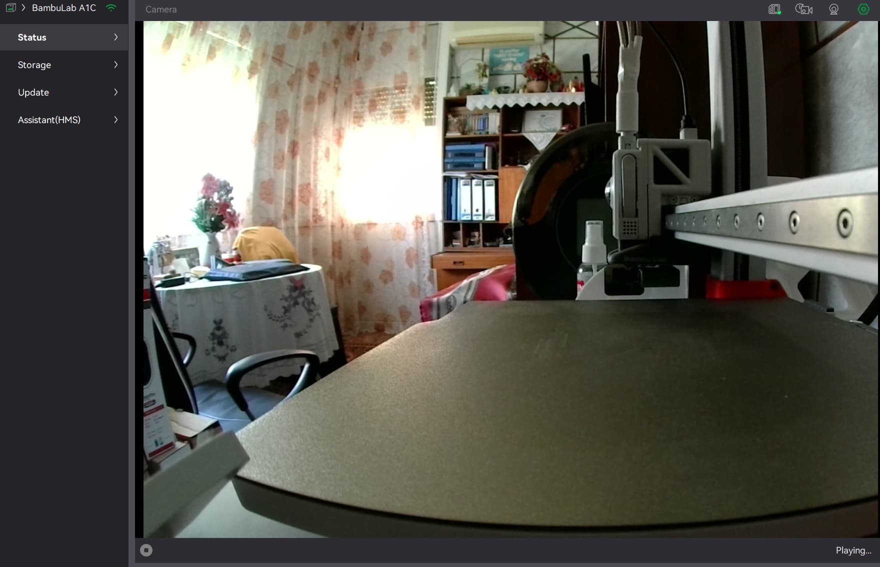

The same issue does not appear on the live feed when viewing via Bambu Studio on my PC.

Not the case here, I can run Bambu Handy and Bambu Studio side by side at the same time with the live video feed and the Studio feed is perfect whilst the Handy feed is corrupt.
I also have the same issue with Handy 3.5.0 and my A1 printer with the live view.
Bambu Studio live view is perfect.
These artifacts appear only on the A1, not on my X1C which is in the same network like the A1. Also, the problem is not related to a specific Android version as it happens on three different Android smartphones (Android 15, Android 12 and Android 8).
Downgrading Bambu Handy to version 3.4.2 fixes the problem.

My filaments and green colors (like artifacts). On the other hand, the pieces are gray in the photos.
So what should be green
Thank you for sharing. I have informed our team and they confirmed the fix should be coming in the next version (a couple of days away).

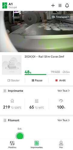

@SupportAssistant Here are the screenshots you’ve requested.
The first two are from Bambu Handy 3.5.0 (normal and maximized liveview) and the third one is from Bambu Studio (latest version)
The update has been published, with the patch applied for this problem.
