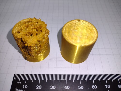

  3. If moisture is still on your list of possibilities, verify it empirically. As noted above, the only reliable method without lab equipment is weighing the filament before and after drying. Drying with desiccant is pointless for this purpose because desiccant only maintains ambient moisture levels. It cannot force moisture out of the polymer. Heat is required for that.
For reference, here is a comparison I use from time to time. This is Bambu’s discontinued golden silk PLA. Straight out of the factory sealed vacuum bag, it still showed moisture. After drying it on a heated bed inside a box, it lost over 5g of weight. That is one teaspoon of water.
I’ll let you guess which sample came straight out of the sealed bag. :joy:
