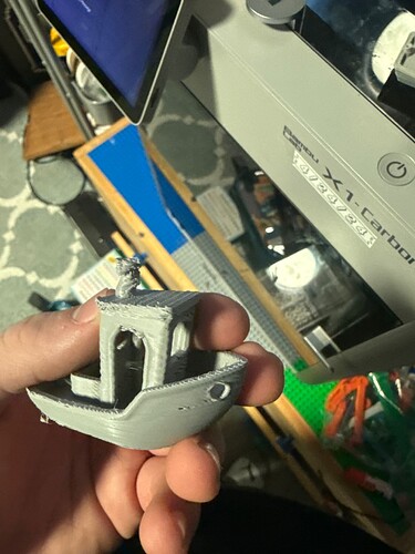

So I’ve been having problem with my printers for a while now because for some reason, the first layer would not go down I don’t know why I put a lot of glue on it. I got new bill plates watching them and I don’t know why but the banshee it’s just looking weird as you can see in the photo like why is it doing that and what does this error mean? It’s like smth about the y axis
Oh, BENCHY!!! You had me going wth is a banshee.
What build plate? What filament? You don’t need glue for PLA on the textured PEI plate.
Have you changed anything recently, like updated firmware?
Have you done a machine Calibrate?
I second a machine calibration, it might be worth checking for a nozzle clog or do a cold pull too. If not that, increase your part fan and slow down print speed :slight_smile:
What are the strings of filament inside on the bottom? Have you lubed and cleaned the z rails and screws as well as x/y and the carbon rods lately?
I have every single type of build plate and ik you don’t need glue but I added it cause it was doing this and still is
Yep I calibrated it still nothing
Yes I did still nothing I even adjusted the tension on the belt
Not the nozzle that was the first thing I checked ngl
The melted smokestack on pic 1 specifically means you have thermal problems - so increase fan, slow down, change nozzle temp, open the door, print a vented riser, etc many solutions
Pic 1 and Pic2 looks like you might be running it with no [or out of whack] pressure advance and fast, so would recommend rechecking that or slowing down
