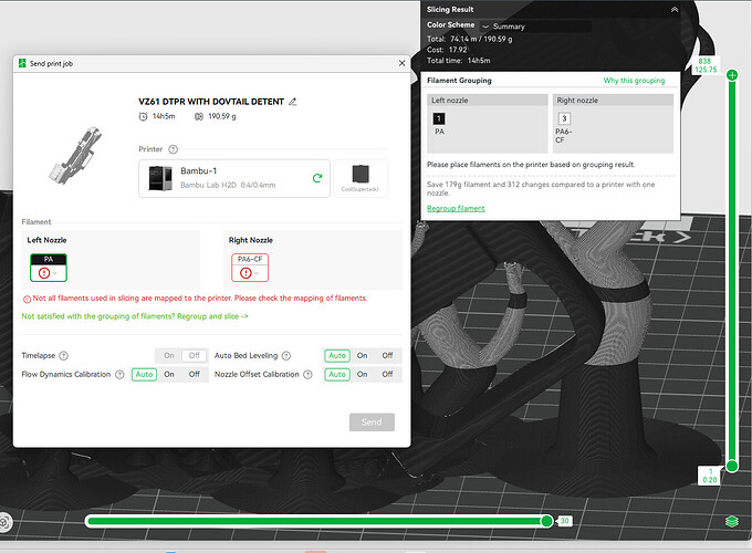

OK so rather confused here…
I have a external spool on the left nozzle and I loaded PA6 in my HT on my right nozzle. I loaded the filament in the right nozzle and when I slice it shows me the correct filament to correct nozzle. When I hit the print button I get this page (see pic) and it says the filamans are not mapped. So I click on the left nozzle and pick the external spool but when I click on the right I am unable to select the HT AMS and can only select the external spool as well. So what am I ding wrong?

PA6-CF is not AMS-compatible. If you put PA6-CF in the AMS HT, the AMS HT can only act as a heated/dry storage box with manual/bypass feeding — it cannot be selected as an AMS source for that filament.
For the right nozzle, select External Spool / manual feed, even if the spool is physically sitting inside the AMS HT. In that setup the AMS HT is not being used as an AMS; it is just acting as the filament container/dryer.
So you are not doing anything wrong by being unable to select the AMS HT for PA6-CF. Bambu Studio is blocking that because PA6-CF is marked as not compatible with all AMS series.
skip AMS blacklist check ? (preferences)

I’ve used the HT for PA6 many times, no issues.
You can set to skip the check. I print ASA CF with the AMS without issues.
If you use it as an external spool it will not feed it automatically, then you need to activate skip blacklist in Studio settings.
