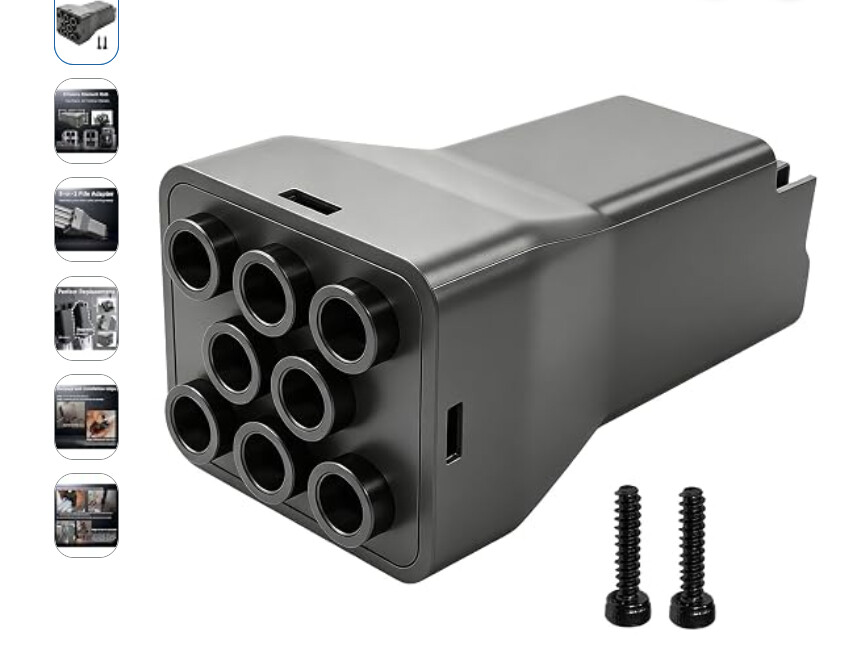

If the A1 firmware were a little more open, something like this [anycubic dongle] would be feasible for DIY’ing 2 ams lite
IDK if its a good idea to drag around 8 tubes though, across many small problems.
WOW!!! That is a nice head! I think it must be a software/firmeware issue.
I realize that, was just commenting on the PTFE tube routing and the fact that they have a second port on the unit.
