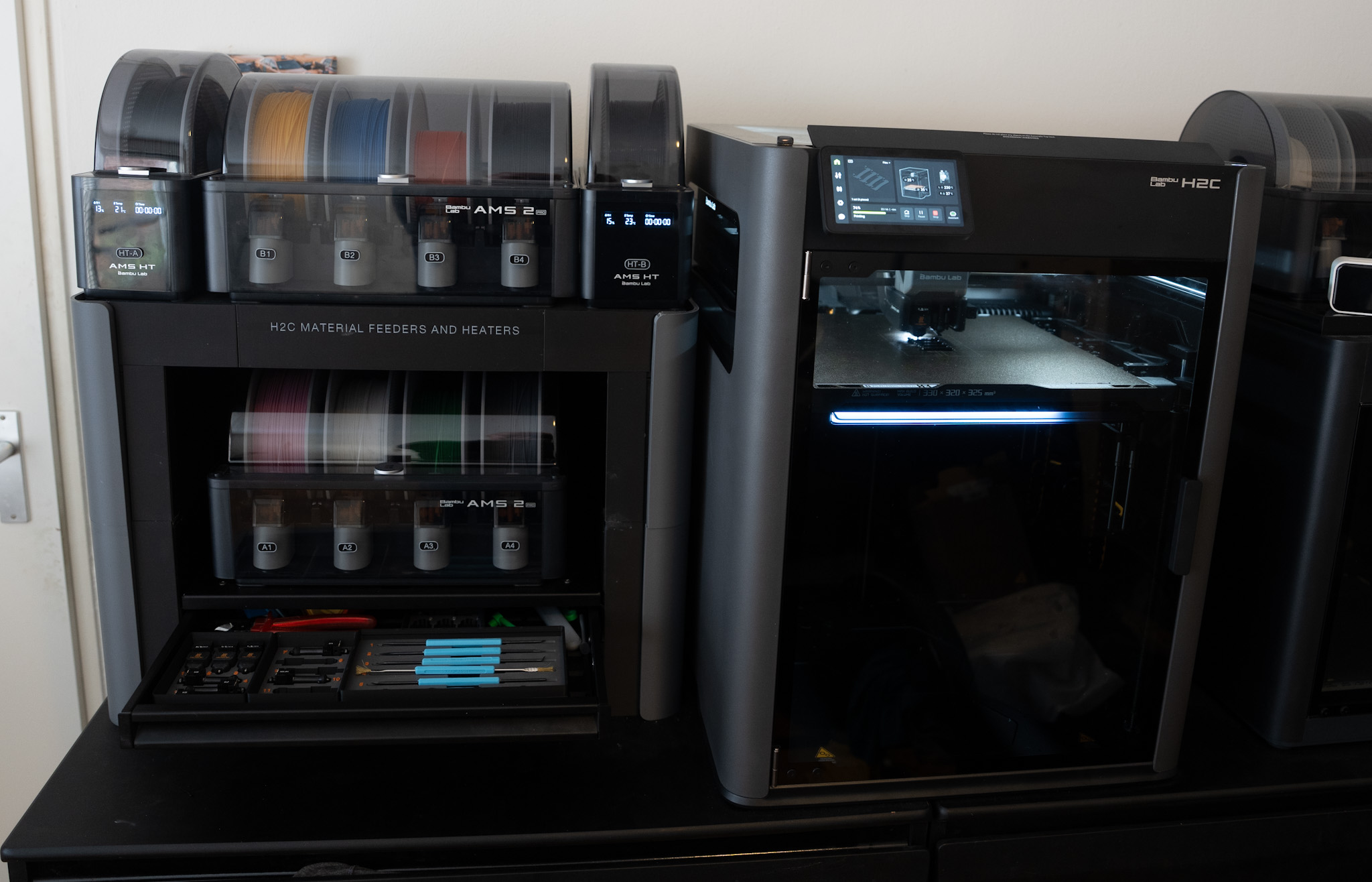

With the h2c you might also want to think about distance on the right nozzle. I have placed the most used closest (ams2 and a ht) then the lower ams2 needs to slide out so takes longer on a switch. The other HT is on the right with optionally the AMS-1 normally on the p1s.
Thanks for the input. I guess I go with the 2nd setup then. Also already considered the longest PTFE run to go to the left nozzle.
yeah i build this rack around that idea so the 5 most used slots on the ams2/ht would be very short ptfe’s that why they are also at that height. The lower one can slide out so ptfe is longer but not much i can do about that. Also added some drawers to get to the correct height… happy with the result but it was some work …

What rack is that? It looks perfect next to your h2c.
I just ordered an h2c and I’m in serious need of an organization system that isn’t “clear some space on the floor beside my desk”.
Here is the link
I build it myself around some parts and 3d printed the rest to match the h2c design. The internal core structure was a $18 garden mini table that would take 230lbs. The lower parts are 19" rack elements that allow me to slide the ams2 out and 2 drawer elements… 19" server rack parts are cheap and well build to last so its good to use.
