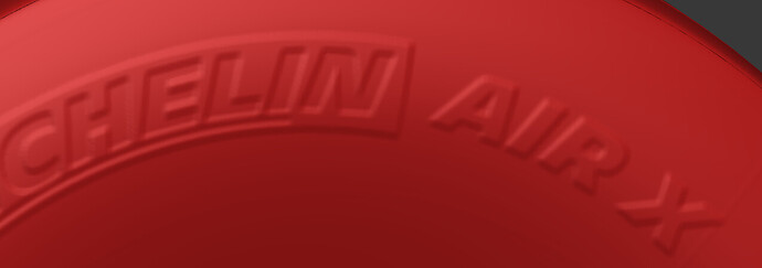

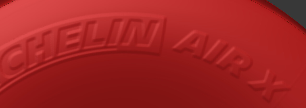

Do you have a 0.2mm nozzle installed? Bambu says it is incompatible with TPU.
My TPU presets are unavailable on the printer and in Studio/Orcaslicer if I select a 0.2 hotend.
That is bad I would print a bas relief and maybe a 0.2 was better for this kind of detail.
But I got it is a clog guard.
