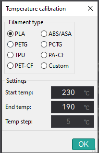

If you want to run a a temperature tower for many kinds of filament, download Orca slicer.
It has a calibration menu item in addition to the calibration project tab you see in Bambu Studio.
When you click on it, you’ll see Temperature as one of the options. Select that and a dialog box opens up that allows you to select the type of filament. The software automatically selects an appropriate range for the filament type, and changes the temperature numbers on the tower to match. You can even change the temperature ranges. Also has a custom option for filaments already provided.
