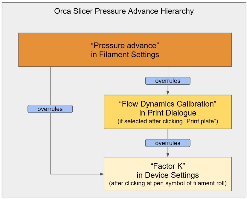

Hi,
since Bambu is still not implementing the option to enter the Pressure Advance value directly in the filament settings and Studio is also still lacking more elaborate calibration methods, one can only use Orca if he/she is serious about filament calibration. I made some experiments and this is my conclusion. Anyone with different observations?
Best
Marc
