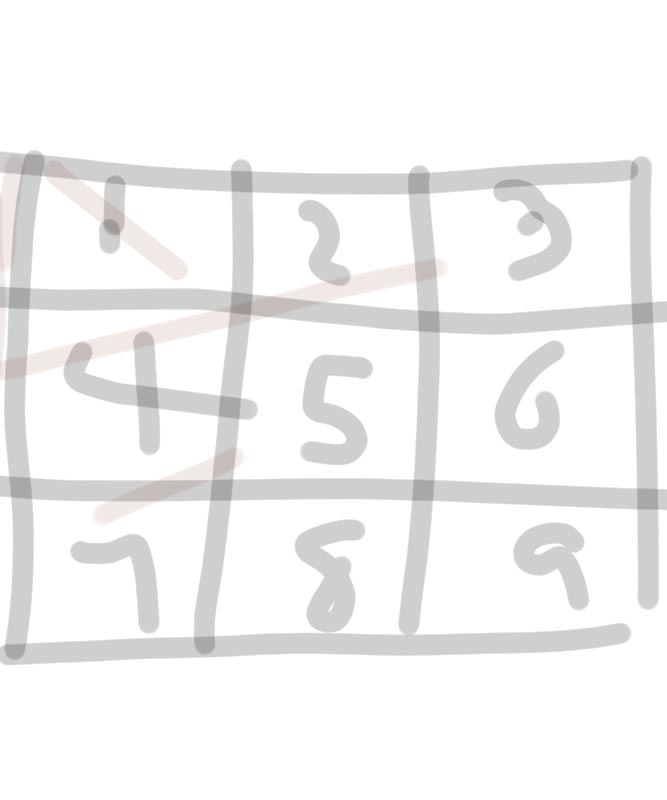

I have a single object that I need to slice with connectors. Each piece needs to be on different plate so I can enlarge them, 1 per plate What is the order to do so and how to print connectors along the way, especially for those that have 2 connectors (e.g. 1-4 and 1-2?
I’m thinking 1-4, 4,-7. 1-2, 7-8, 8-9

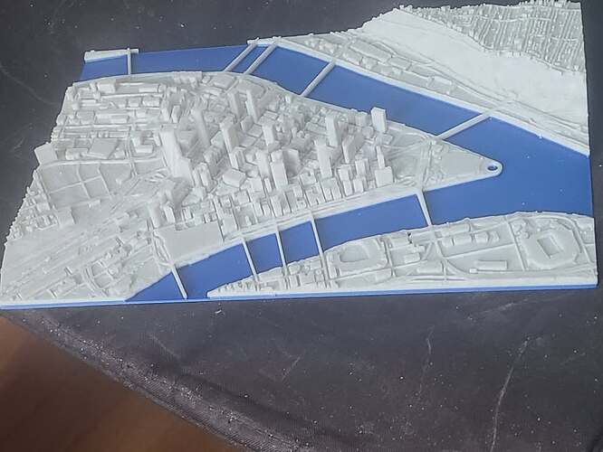

Here is an example. I want it much larger, so I want to cut the model 3 x 4. I take each 1 to a different bed, which I then enlarge more.
I’m wondering if it will b tough to line; when re-combinong up as for some, a connector in 2 places. How can u align them when 2 need to line up.? Possible but I want to keep connections low.
So I want to cut it with connectors. So I’d like 2 know where connections should be.
Many thanks for that. So a city/landscape, thin and wide, with vertical cutting surfaces. Is the blue an infividual object/part or was it painted?
First, I’d change the sequence. Increase the scale, then cut. You do not want to mess with scaling effects on your connector cut outs.
As for connectors, you have a few options. Two swallows tails per cut would be good, but in Studio, you can only do one per cut. But the problem description clearly asks for two (or more) connectors per cut. So unless you want to use CAD for some more suitable clamping connectors, you’ll need to limit functionality to positioning, relying on glue (I have had good experiences with “Kraftprotz”) to hold the parts together. The “snap” type connectors allows some clamping to occur, but being severly limited in thickness and orientation being a bit of a pain, this will probably not really hold things together.
Locationwise, I’d go for locations between 1/3 of the cut length and the edge. Minimum distance from the edge should be between 1,5 and 3 times the connectors smallest diameter.
There’s a caveat though. Due to the very thin model, local deviations may occur in z. In particular the cuts through the river may be problematic. So the smaller the connectors are, the more you may need. Could be as much as one every 75 mm.
Personally, I’d recommend considering some CAD work.First a thin double dovetail connector, then increased in all dimensions by 0.05 to 0.1mm. The second can then be used multiple times with a negative boolean operation on the bottom of the landscape (after cuts along feature lines like roads or river banks). In particular hiding cut lines takes quite a bit of CAD work, but you could hide most cut lines, the connectors would only be visible from the bottom of the model and you only need a large enough flat table for the assembly (ok, a bit of “Kraftprotz” doesn’t do any harm :joy: ).

From the above 3 x 3…can’t I cut between Col 1 and Col 2, separating the left ccolum. I then can put connections where they need to be (say 1/2 up each small rectangular pieces). Then do the same buy cutting between Col2 and Col 3. At that point, I can start cutting along the x axis and do similar actions.? I don’t think it fails by 1 cut - 1 conectors
You can actually put as many connectors as you want per cut. Only the swallows tail cutting tool is limited to one.
I think it is best to try out a few variations in the slicer. Don’t settle on the first attempt but try a few different strategies and then think about freedom of movement for each.
No need to slice initially. Just to learn the different aspects of the cutting tool.
You will soon settle on an approach you are comfortable with.

This is what I think I should do in terms of connectors between which plates:
  1. slice column A (1-4-7) and column B
  2. put horizontal connectors to connect column 1 to column 2 (3 of them)
  3. slice to separate col 2 and col 3
  4. put 3 connectors between them
Is it ok to just put in horizontal connectors, or should I add a few vertical ones?
