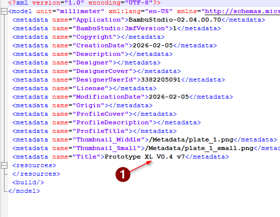

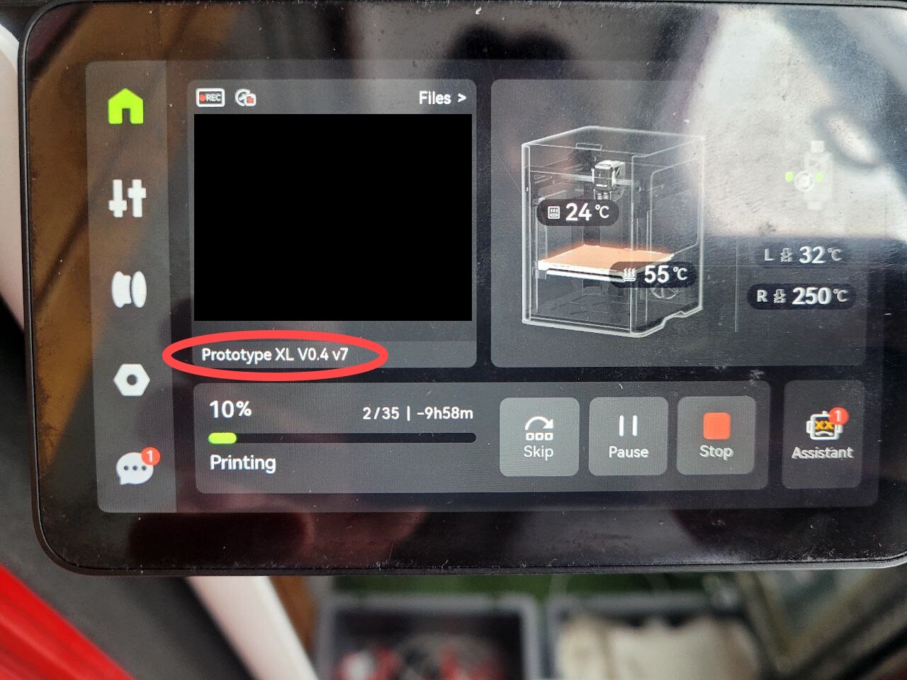

When uploading g-code via any method, the model name in the 3dmodel.model file is way outdated and does not change with model name changes in software (see attached screnshot, where the Title is months old and should have undergone numerous updates by now). This greatly affects the ability to tell files apart on the printer screen.

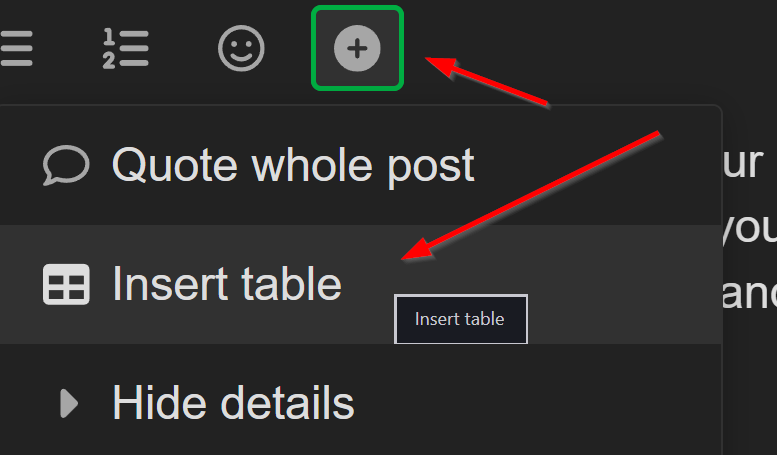

Then click the insert table function.

The title is shown in 2 places.
  1. The main print screen
  2. The setting selection screen after selecting a print file and before the job start
Due to the character overflow limitation of the main print file menu, even just mildly long print job names cannot be read in full. When opening the print job, only the title is shown, which is affected by this bug. This means that there are circumstances, when two print jobs cannot be told apart.
The title appears to be taken from the file name of the first 3mf that is loaded into a project. Saving the file under a different name or loading other objects into the project has no effect. As far as I can tell nothing can be done to change the title once it is awarded.
It would be very simple to fix this bug, either in FW or in BS, by either getting rid of the use of the title field altogether, or by properly updating the title.

I print about a dozen different items for work. I use the same profile settings for the most part, and can basically use one file / 3mf and just change out the components within it for different STLs that I need. What I find is unless I make a brand new 3MF for each one of my products, I will often have an incorrect name show up in the status box that shows printing time. It will also show the incorrect file name/stl name on print history on the printer itself.
I believe this file name comes from the very first STL model you import. Is there a way to change it? Would like to have the status display the correct model name.

It was taken from the file name of the first object that was loaded into the project. I’ve already stated this previously.
