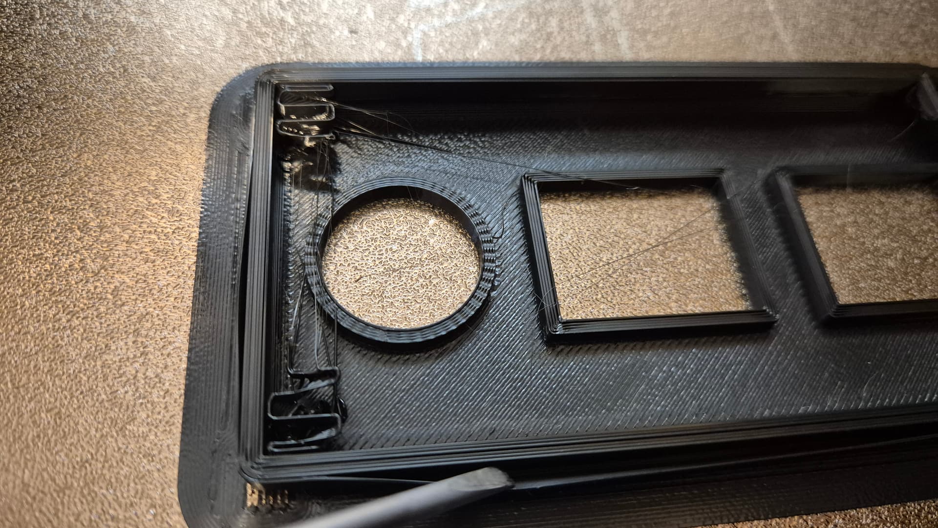

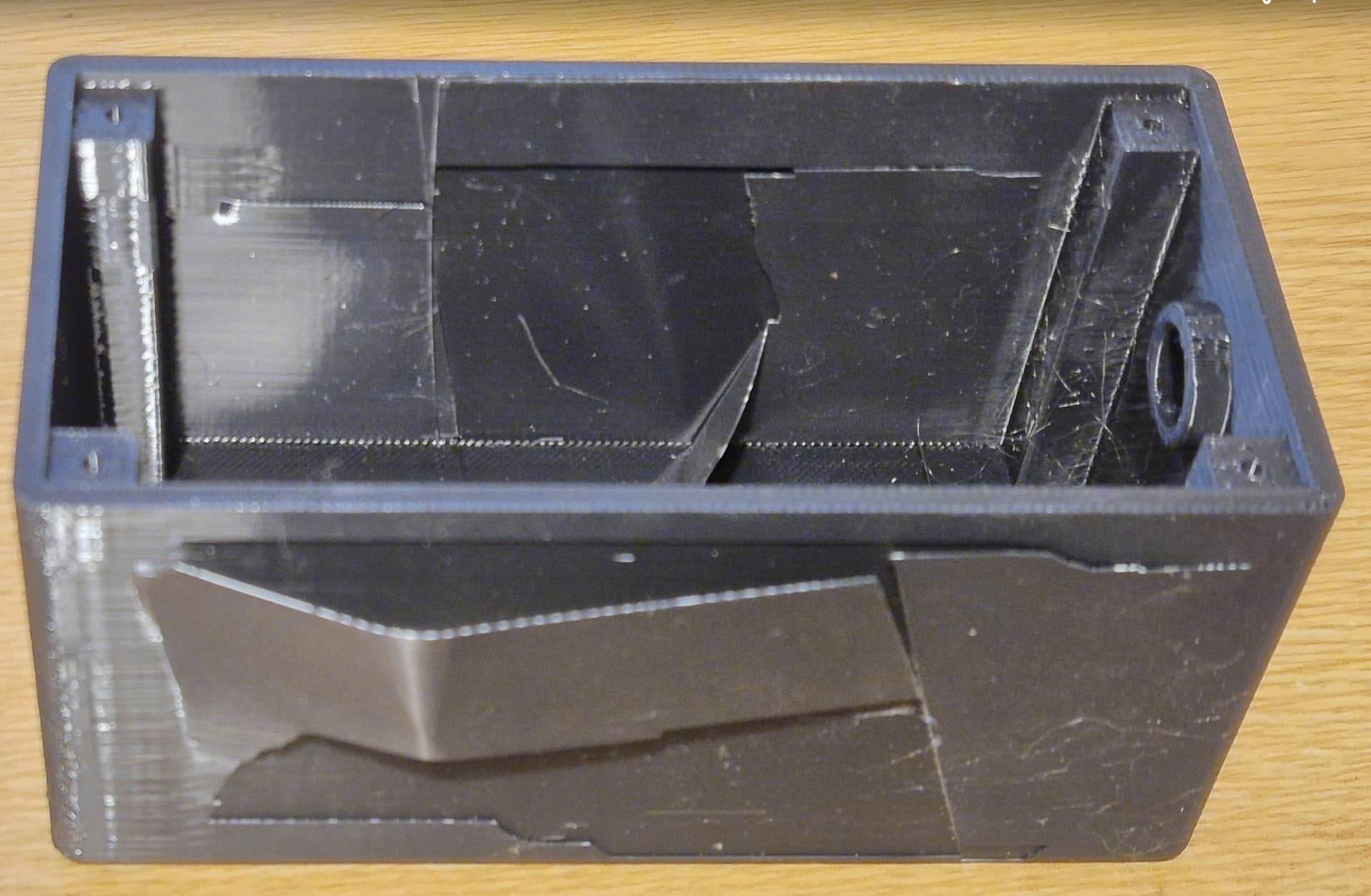

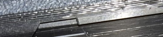

the “front outer” layer as viewed and printed doesn’t seem to be sticking to the other layers…I sliced it with a knife as per attached pic and it just fell away, same on the "front / inside of the rear wall
All others seem to stick OK
Looks to me like you’re under extruding. Partial clog, issue with Extruder stepper motor or drive gears…

it only appears to be happening on what I am calling the front vertical wall…i.e. the face you would see if standing directly in front of the printer

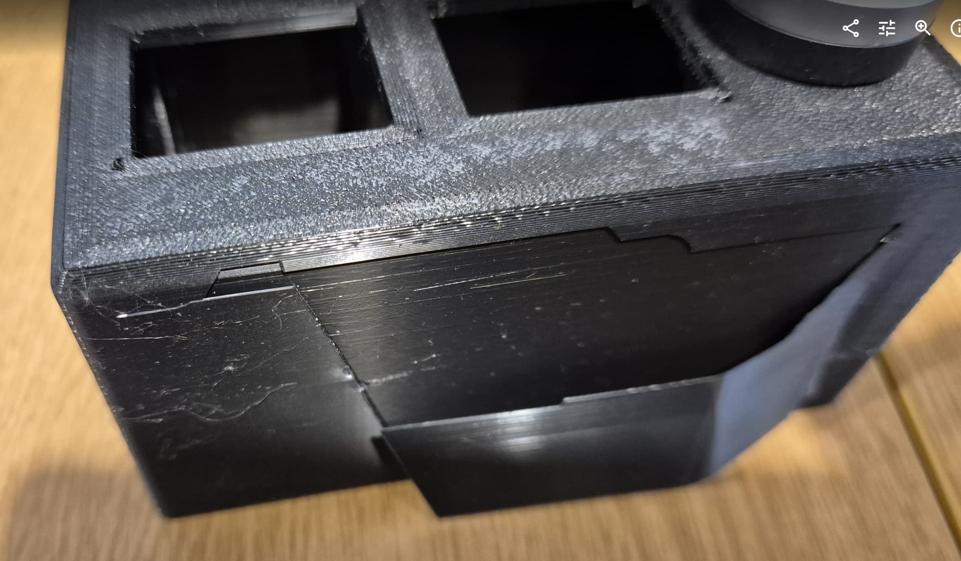

another pic…I ran a knife through the faces and the layers just peeled off…other faces seem OK as do other layers although they can be peeled off rather more easily than I would have expected

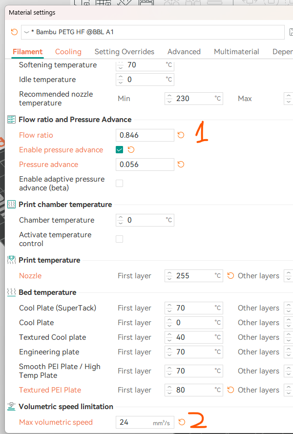

3 things stand out bigtime relevant to the problem:
  1. This seems very sus. Flow rate really shouldnt need to be adjusted that heavily, something else might be very wrong if that is your real needed flow value. If this flow rate is wildly off, it will WILDLY exacerbate problem #3’s layer squish. Recalibrate before going any further IMO
  2. I dont have experience with HF PETG but every regular PETG i’ve ever used has had better layer adhesion the slower you print it, and you got yourself a layer adhesion problem, so i would reduce this.

I will address these points and try again…but why would it seemingly only affect the front faces?
Why the front faces only, I’m not so sure. If you follow the preview’s playback you can see that of the 7 total wall lines, 4 of them are printed with air gaps around them, so those (IMO) underextruded lines just don’t connect side-by-side, but definitely connect top-to-bottom

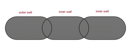

This infographic isn’t quite perfectly applicable since you have more than 3 walls, but I hope you can see what would happen to the overlapping area if the lines were only 84% as fat. not great contact with walls, great contact with layer below, would form as a series of 1-line-thick vertical sheets.

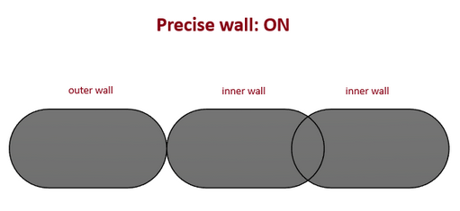

  2. Flow precision - because bambu printer profiles regularly make the line width WIDER than the nozzle aperture, means that the layer is squished down, and fills to the edges, like a slightly inflating balloon. That means that every molecule of underextrusion contributes exactly to reducing the width of how inflated that wall got. You also have precise wall selected. See this diagram for what precise wall does:
I said all that to say this - In this last test, are you only able to peel off ONE wall, or do you have many layers of wall flaking off still? If only the outer wall is not adhered - try again with A) more flow or B) precise wall off or C) both. I know your test said 0.95 but try 0.99 or 1.00 for a giggle. Being even EVER So slightly off in volumetric flow will cause those two squished lines to not kiss when precise wall is ON.

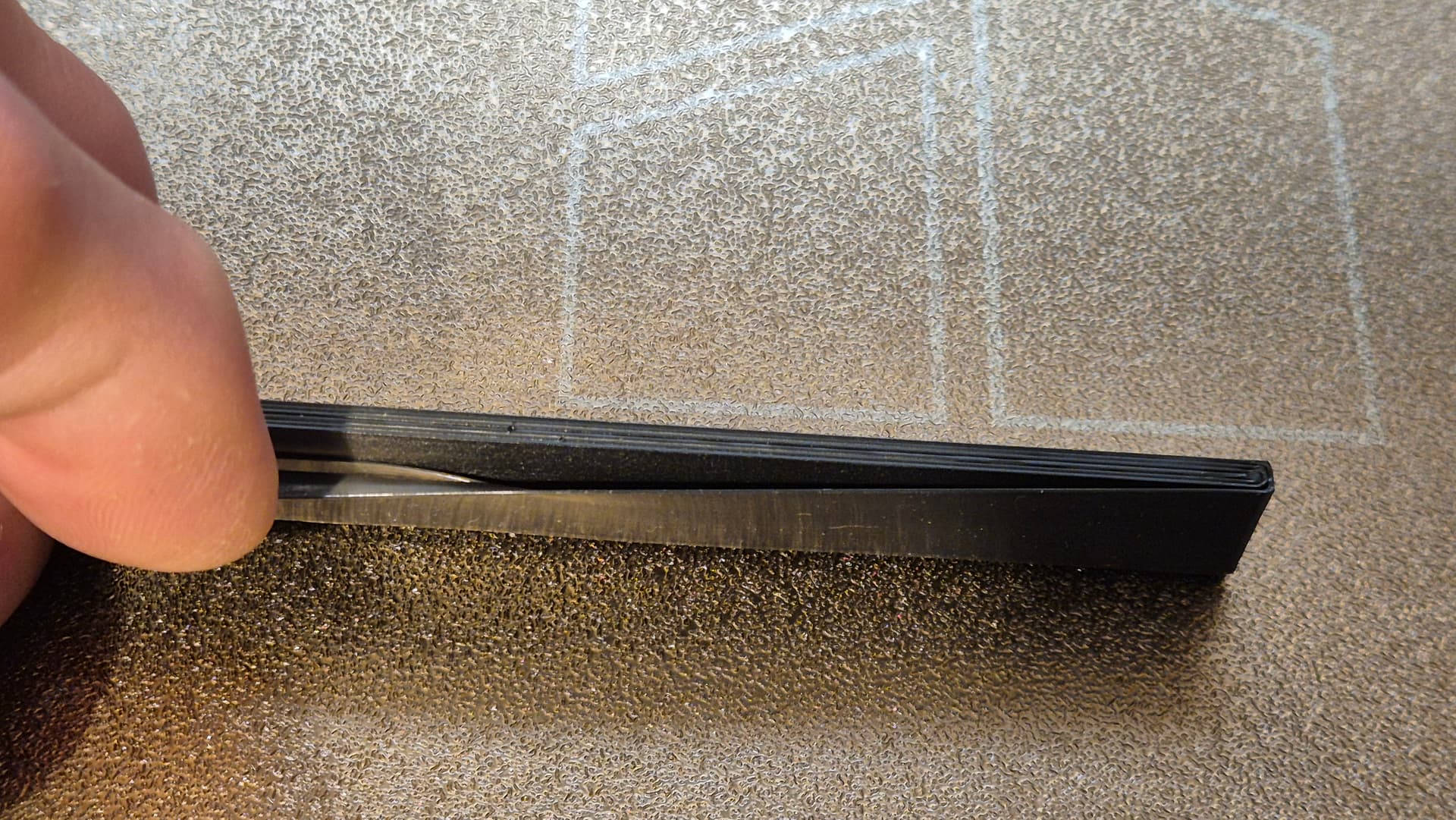

yes, it is ONLY the outer layer and always the one nearest the front of the printer…if it was a box then the inside wall of the back of the box would again be affected
I did a smaller test piece (attached test 2) and stopped it before the top layers were printed…and it was the same again

excellent test setup. I think you’re still underextruding barely, and precise wall is a setting that punishes “under” a hell of a lot more than it is impacted by “over”
