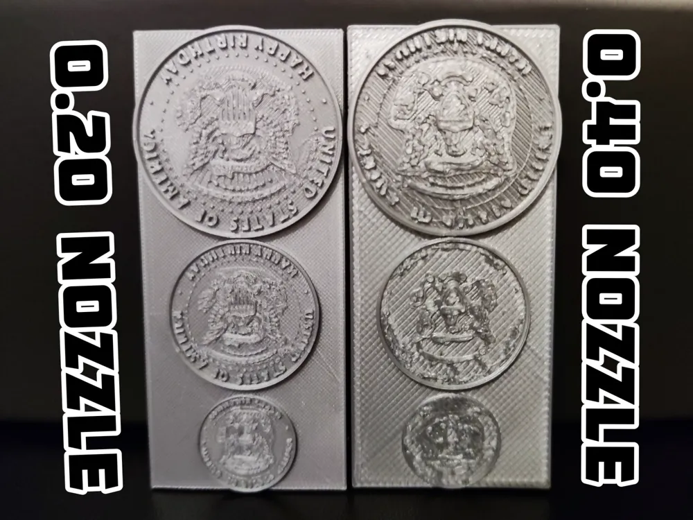

To further improve the print quality, you could use a 0.2 nozzle. Details in particular benefit from this, but it only makes sense if you can compensate for the time it takes by grouping objects together, as MalcTheOracle said.
I’ll dig out my good old example from the drawer, especially when the objects contain text:

If you do not have the smaller nozzle, you are limiting the achievable detail. You asked how to get the best quality. A smaller nozzle is one of the primary levers.
The second lever is speed. Either reduce overall speed to 50% via silent mode or manually lower top surface and outer wall speeds, depending on the geometry.
