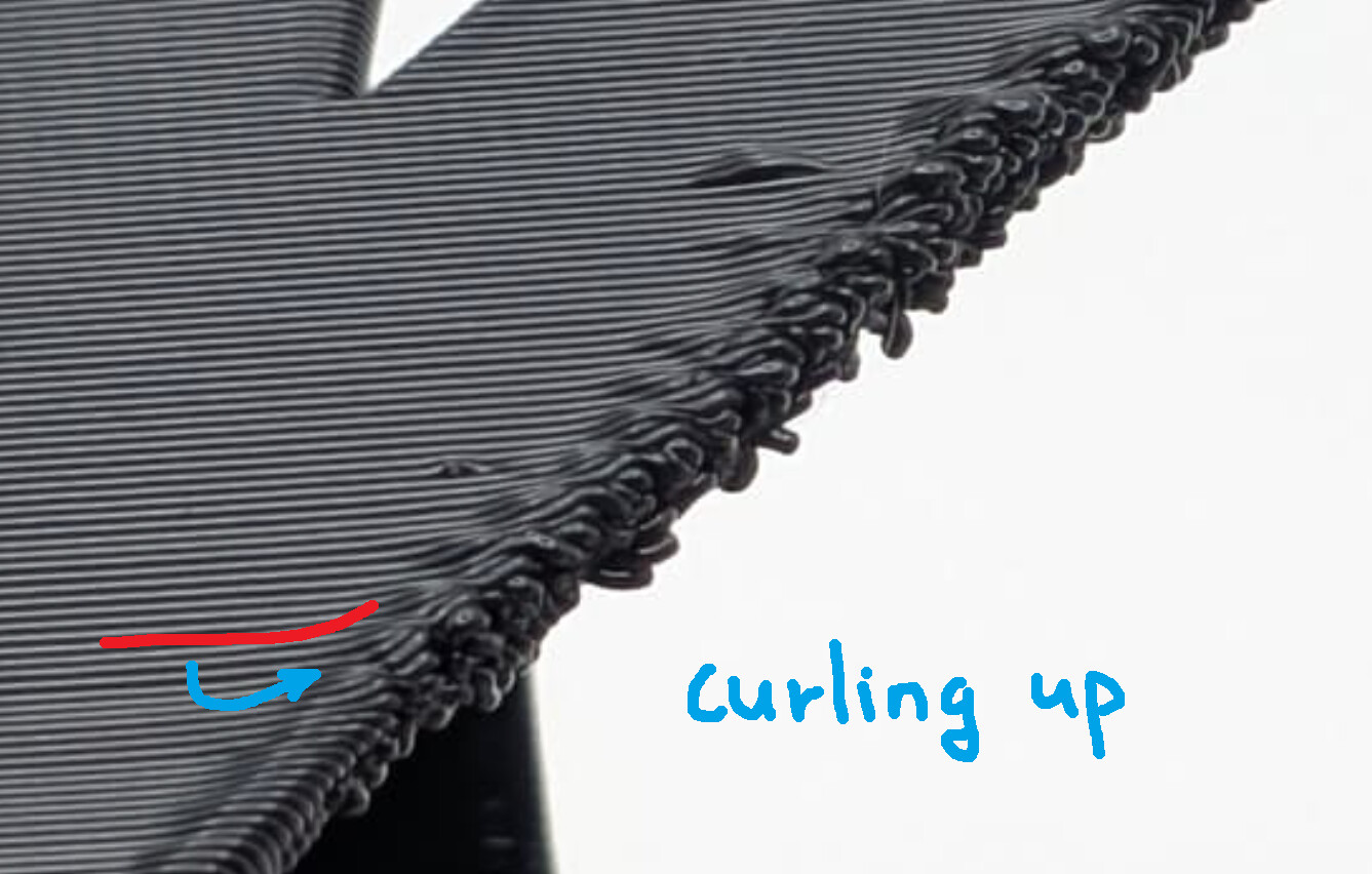

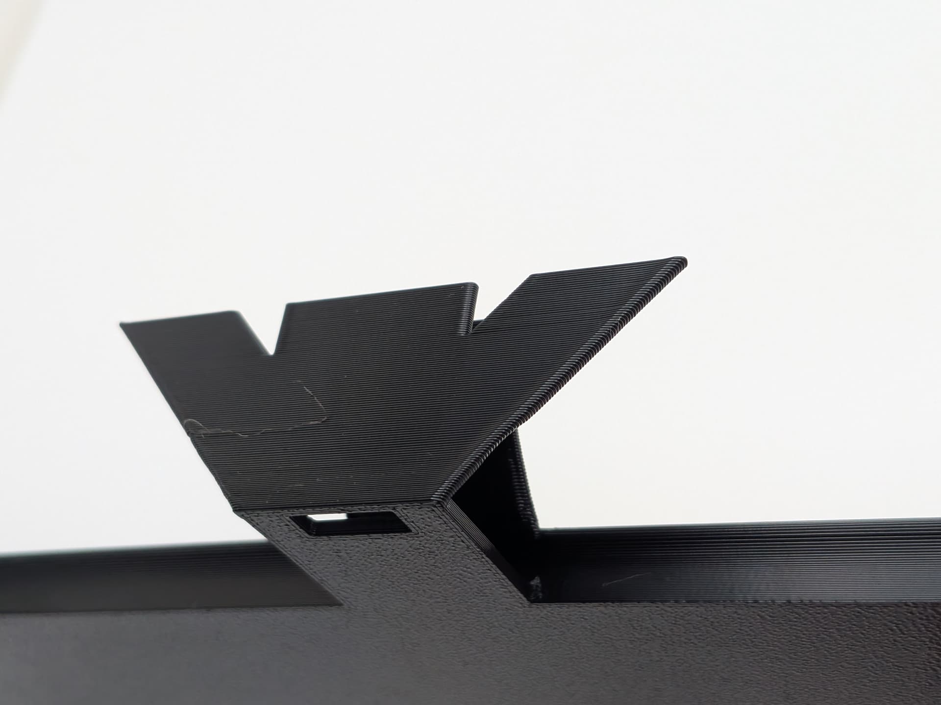

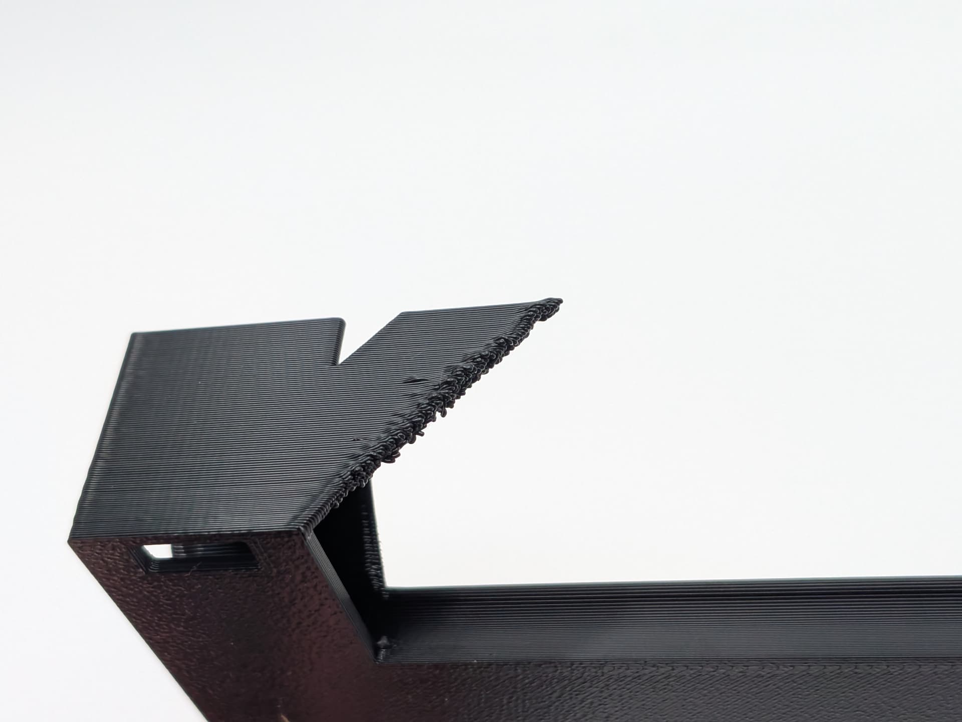

Right now I’m running a print that has failed overhangs in some places, but in other places (with the exact same feature) its failing? I’ve tried on both a P1S and H2D with the same outcome, so I know it has something to do with the settings. I’ve slowed everything right down for speed and accel, and using default filament profile with calibrated K values.

I’ve tried the seam preview, and speed/fan preview with no differences or seams to report. Also the model is mirrored left and right so I know the angles are identical.

Do you notice how the 90 degree corner on the first pic also looks bulged, like it was an out-of-spec pressure advance at that flow/accel. I don’t have a good theory for how thats possible on the same part with crisp PA-looking lines on the other side.
Without just because its a 50 degree angle. Should be more than able to handle that in my experience.

This is the proof of not enough cooling because of layer time is too short. The matter becomes worse with seam located there.
