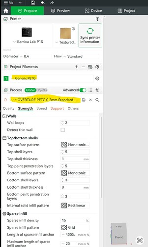

I bought a roll of Overture PETG, used the generic settings and got ok results. The Overture website has a profile for the Bambu printers that I downloaded. When I uploaded the profile, all looked good, but then I can’t find a way to select it in Bambu Studios.
Can anyone help provide any guidance?
Best… Richard
In Bambu Studio in the line that says Project Filaments, at the right hand edge is a settings symbol. Click on that. In the pop up window there are two headings; System Filaments and Custom Filaments. Click on the Custom Filaments to set it up.
When selecting the filament for a print it will be in the Custom section in the pull down menu.

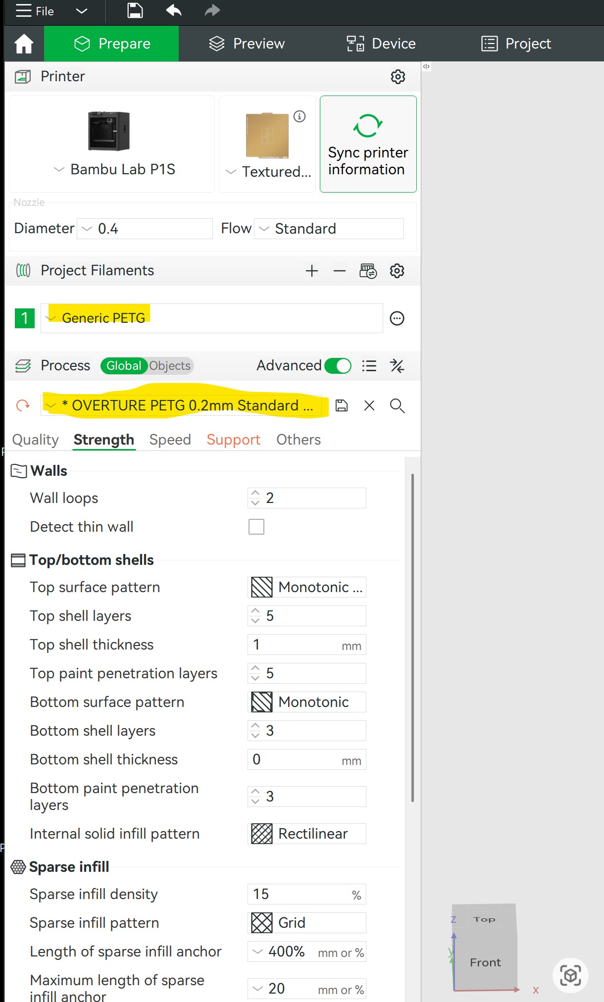

Thanks for your thoughts, Ed. What you described is exactly where I looked for the profiles after I imported them from the Overture Website. Unfortunately, they were not there.
The screen shots below show exactly where they showed up. For what its worth, I printed a number of parts with complex geometry with Overture TPU and PETG using these settings. They all printed awsome!

There are NO filament profiles for the P2S (yet).
Ouverture only has profiles for A1 P1 X1.
I’ve just found that myself
Overture printer profile wiki points you to the download site but when I download and unzip the PLA folder, there’s nothing for the P2S.
I installed the P1S profile thinking it wouldn’t be that different, and it appears to be installed OK
But when I try to select it, Overture appears in the list of unsupported profiles. I couldn’t find a way to persuade Bambu Studio to use it.
Any ideas?
Since the P2S use a different extruder and hotend, the P1 profile will be wrong anyway.
I’ve contacted Polymaker a while back, and they replied the P2S is too recent for them to have dedicated profiles (yet). I guess this will be the case with other filament brands, too.
For the time being, P2S owners have 3 options: use Bambu filament, use the Generic filament settings, or create their own profile.
