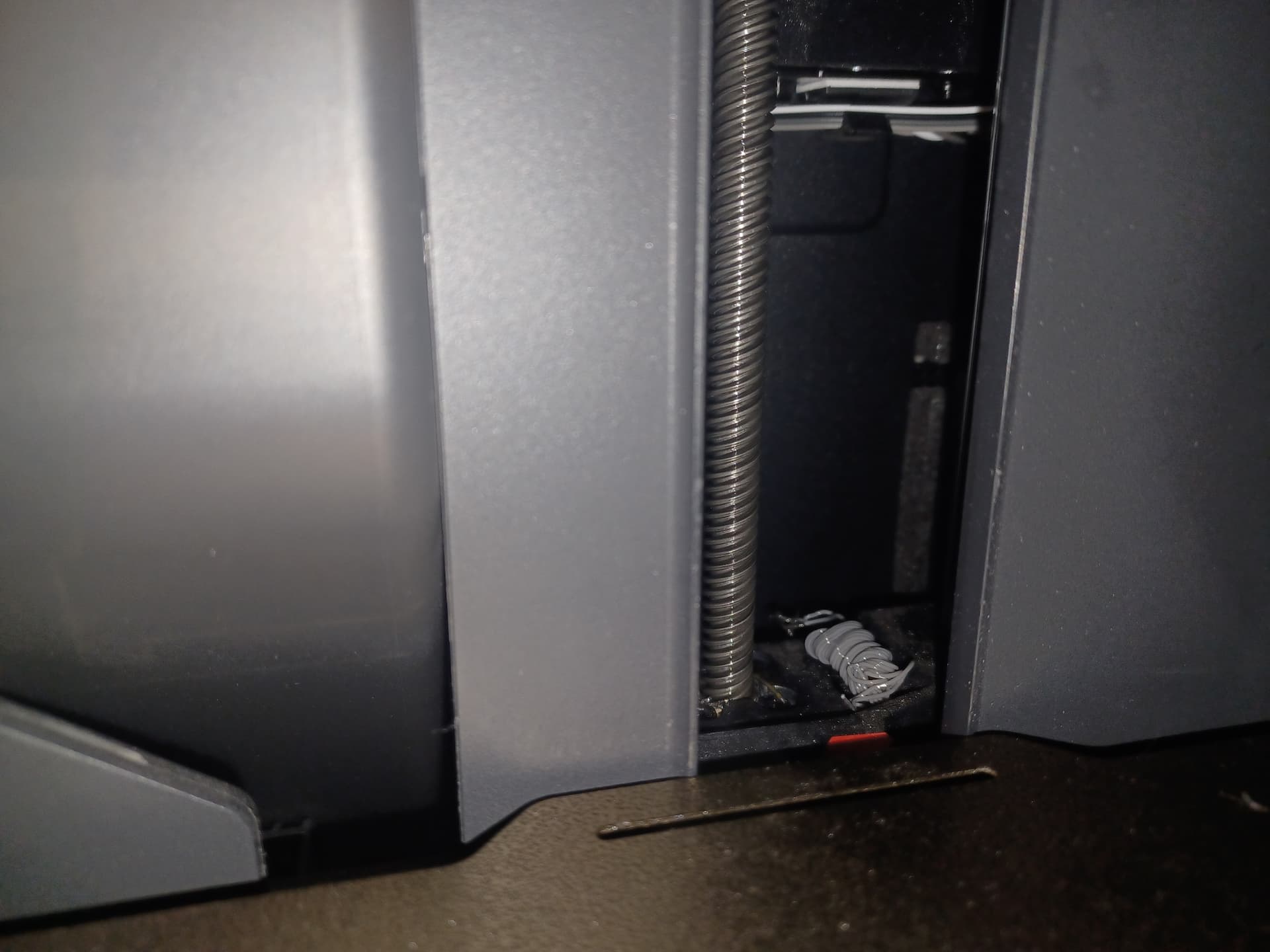

I know this is an old issue and I have read a bunch of “fixes” but nothing works for me. Maybe this is an issue with the latest update from Bambu Firmware 01.08.02.00
I can get the printer to do a Z-axis homing successfully, but when a print is started the build plate will not come up high enough to touch the print head. Then it gives me a error code: 0300-0d00-0002-0005 ( build plate not properly placed ).
The build plate is perfectly placed, nothing is obstructing the bed from moving ( it had just finished the homing and was touching the print head ).
Anyone heard of a bug ???
make sure there is no poop on the back lead screw platform… funny i was going to take a picture to show you where and I happened to have a piece there as well lol
No poop anywhere. I have been very diligent in removing all ( even using vacuum ). Like I said, the Z-axis homing process works fine but the print will not occur.

It almost sounds like some dirt or debris got trapped in the belt under the printer, temporarily blocking or just hindering z-axis movement…
Not likely, because the homing process works if I do it before the print each time. Not just a one off occurrence .

Problem solved with information from youtube. There are 6 screws ( in pairs ) at three locations on the print bed just at the base of the each vertical screw drivers. I loosened them all just enough to pull the bed just 1 mm ( paper thin movement ), hardly noticeable. Then re-tighened them. Could not believe such a small movement was responsible for the issue. I’ve made two successful prints so far. Guessing it’s fixed.
