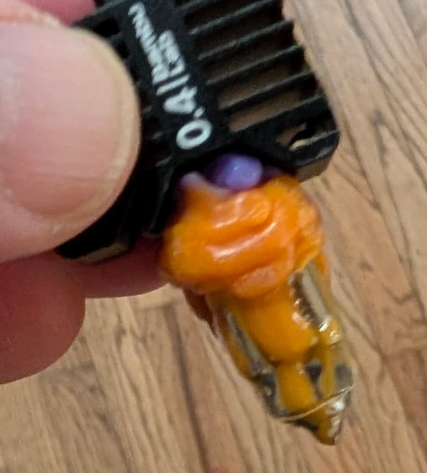

Hello. I am new to printing and have a P1P printer. A few weeks ago, I had filament ooze out of the .4 nozzle and it ended up covering everything including the fan. I replace the entire head and opened the extruder to oil the gears. I replaced the head but then the prints would not stick the bed. Now today more filament oozed out and to the point where the rubber sleeve fell off. What is going on!! I have tried Bambu filament, generic filament, drying the filament, washing the bed, and still this happens. Not sure of any other setting because I dont even know what most of those mean. Please help!!

Is the print detaching from the plate, then riding on the nozzle, “blowing a balloon” starting from the tip? Or is it leaking out from the supposed-to-be-sealed connection between the melt zone and the heat brake? The first implies settings/cleanliness, the second implies a broken or improperly installed nozzle

I have a video but the board wouldnt let me post it. It just drags the piece around the plate.
First line of defense: Wash the plate
Hot water, regular unscented dish soap (ex: dawn), a nonabrasive scrubber brush/etc that you have not used for dishes, soap it down, scrub it up, rinse it off, repeat, dry it on clean stuff and hold it by the edges. Some people, including myself, also do a spritz of isopropyl alcohol and wipe it dry (do not let this step air dry). Invisible oils love to screw up plate adhesion.
After that, do a first-layer test, peel it up and lets see a pic of that from the top and from the bottom. In the slicer, on an empty plate, add a cube, and resize it down flat. Lots of folk do it as full 250x250x0.2 cube but a quick 100x100x0.2 will also tell us some stories.
This failure mode occurs when filament fails to adhere to the build plate and instead accumulates under the nozzle. When adhesion fails, molten filament has nowhere to go and pools under the nozzle and follows the path of least resistance, which is upward and around the hot nozzle, collecting underneath the silicone sock. That is exactly what your photos show.

Based on this photo, first layer adhesion failed from the very start. The filament was not sticking during the initial layer at all.
Under normal circumstances, first layer adhesion would be the primary focus. However, since you mentioned prior nozzle damage, that should be ruled out first. After that, these are the most likely causes to evaluate, in order:
