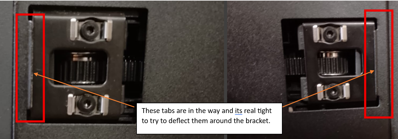

My third question is the fitment of the rear P1S panel. There are tabs around the belt tensioners, and they don’t seem to fit. I could probably shove them in there but I feel it would be impossible to remove.

They do, that was done intentional. Not sure why, but it is what it is.
See installation - step 1
Thank you for the response. It is good to know the panel is normal.
