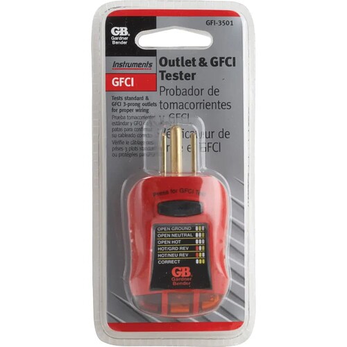

If you have concerns about your wiring you can get something like this (not sure what country you are in, this is for US)
You just plug it in and the lights tell you if it is wired correctly.
