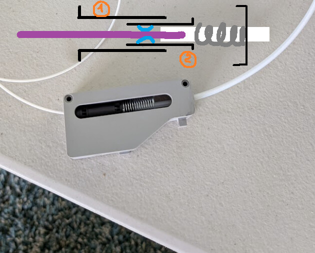

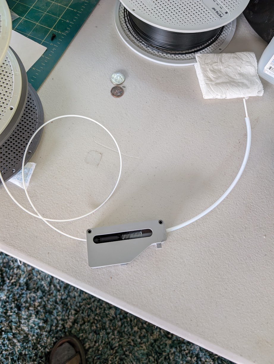

So the point at which it stops there is no snag. I ran some filament through it manually:
and it’s smooth as silk.
Can someone explain to me, technically, what this thing does? I know it’s got a Hall sensor which I assume reads the movement against the sprung slider, but in my case the fllament moves through and nothing internal to the device moves at all.
Bottom line it’s absolutely not a path problem.
I can order a replacement of this assembly I believe, but I’d like to know how to determine that it’s failed before I do. The PCB looks fine.
Thank you,
There should be some mechanism like the blue thing inside the moving part (2) to pinch the filament. So that that part (2) would move along with filament when pushing filament from left to right.
The part (2) has a magnet that triggers a hall sensor when it is at end of its travel. This to tell the AMS that the AMS doesn’t need to push filament in anymore, relax the assist motor until the spring moves part (2) all the way to the left again. That why this is called “AMS buffer”
Since the grippy mechanism (in blue) allows filament to slip, it’d be under subject of wear very quickly if filament in used is abrasive type
As far as your question about the buffer, if you haven’t used it much, the wiki is very handy and has lots of information. The buffer acts as a sort of shock absorber for when filament is being fed or retracted. If the spring and slide inside the buffer move freely it is probably okay
Passing filament through the device on the table like that has not a good indicator because it is not reflective of the curves and bends when every thing is mounted.

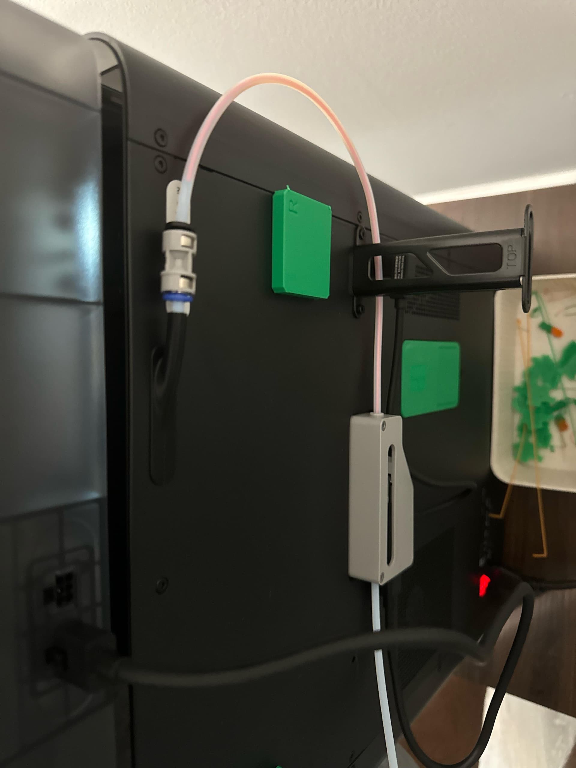

When the PTFE tube is mounted to the printer at one end and the AMS at the other end, the AMS pushes it from the AMS until the extruder grabs it.
If you force tight radius bends in the PTFE tubing, the filament is going to ride against inner wall of the PTFE but against the outside of the curve. Tight radiuses will cause the tubing to wear out faster because the filament, being stiff will ride against the outside of the curve. Tighter curve more pressure and rubbing of filament against tubing.

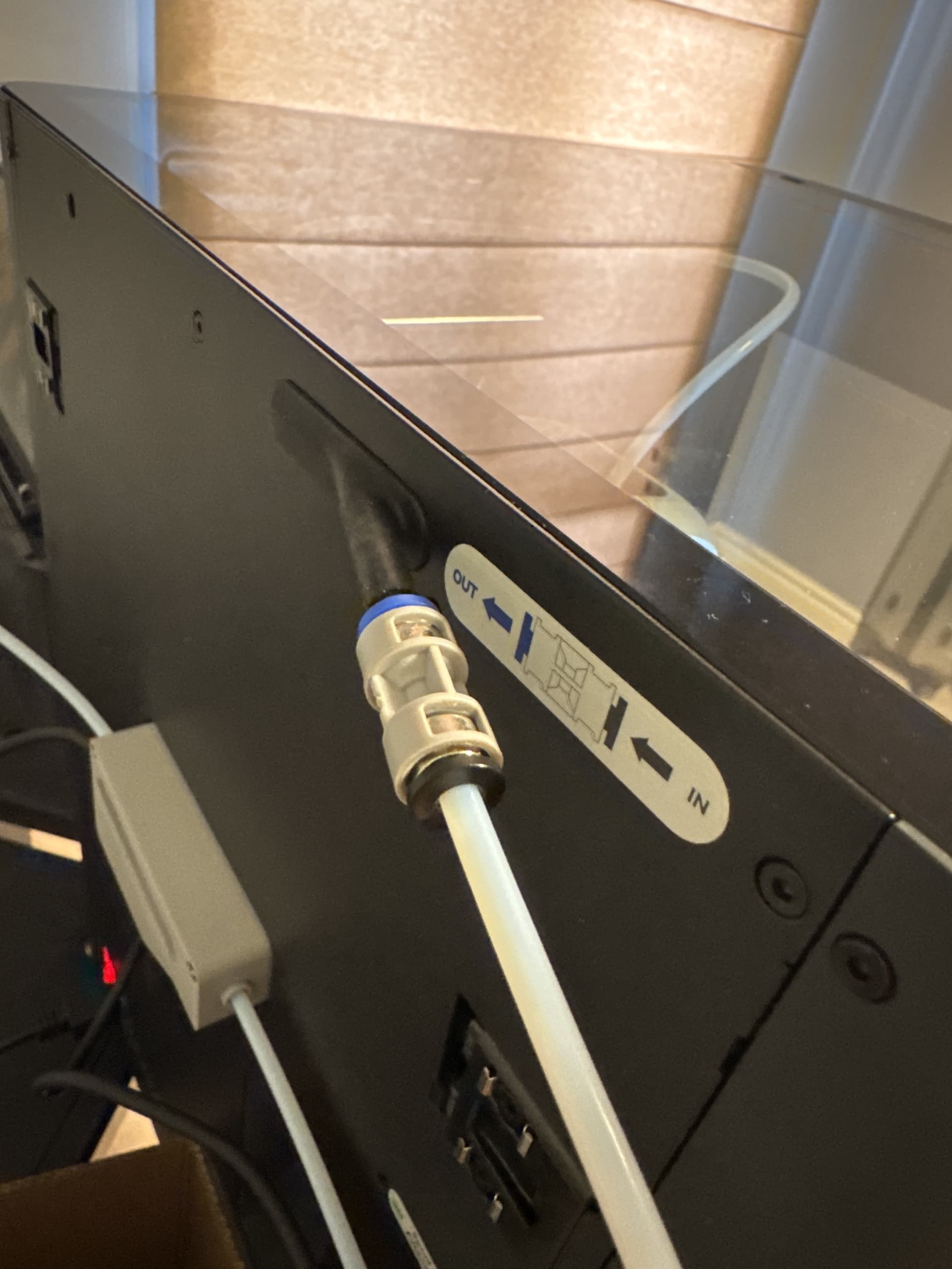

The still of your YouTube video, it is easy for me to imagine that the filament is making a tight turn and potentially can snag the coupler internals.
You want the run in to the coupler to be straight.
Try running the PTFE so it is straight and runs out the edge of the picture on the right side and then goes under the the manual spool hanger.
Here are some pics of how you want the tubing as it approaches the couple going into the printer body. I got those from a Google search and the bottom picture, I would have a longer run of tubing between the buffer and coupler so the run to the couple straight like the top picture.
Buy the tubing in the longest single piece you can buy so you can cut it to fit and not have tight radii anywhere.

replaced the filament buffer and exactly the same behavior. It does not move the spring assembly at all.
@Simon14 The new buffer exhibited exactly the same behavior as the old buffer when tested on the bench, no resistance, no spring movement, nothing changes at all as the filament moves through the buffer. Same in situ.
@Wsquared58 To test your theory of the bend radius being too tight I simply removed the other end of the tube from the machine and let it hang loose. Exactly the same behavior.

OP did you ever resolve this? I have the exact same issue right now. Filament stops mid way in the PTFE bend towards the blue / black coupler
I am not going to read this whole thread but allow me to make a suggestion few bother to look at.
It is possible that your PTFE tubes are worn in one or more spots from the feeder to the print head.
There are 4 internal tubes in the AMS, one from the AMS to the hub, one from the hub to the coupler, one from the coupler to the print head. If you’ve never changed them the ID will wear and cause feeding issues.
Another issue could be a broken piece in the coupler. You wouldn’t see it without taking the tube out of the end and looking.
Lastly, and doubtful if this just started, but less so if you’ve never changed the tubing, the bend could be too sharp an angle.
You can pull the PTFE and look carefully at the end. If the ID (inner diameter) looks misshapen (should be a circle, near perfect) then it’s a good chance that’s the culprit. If you’ve never changed the tubing than that wear will be within nearly all tubes.

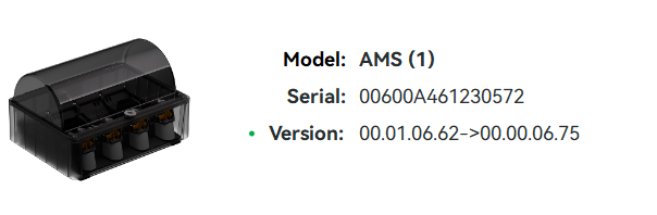

I will, for science, hook it all up again and see if the AMS gets a firmware update and maybe they quietly fixed it.
Indeed the firmware did update, but nothing changed.
