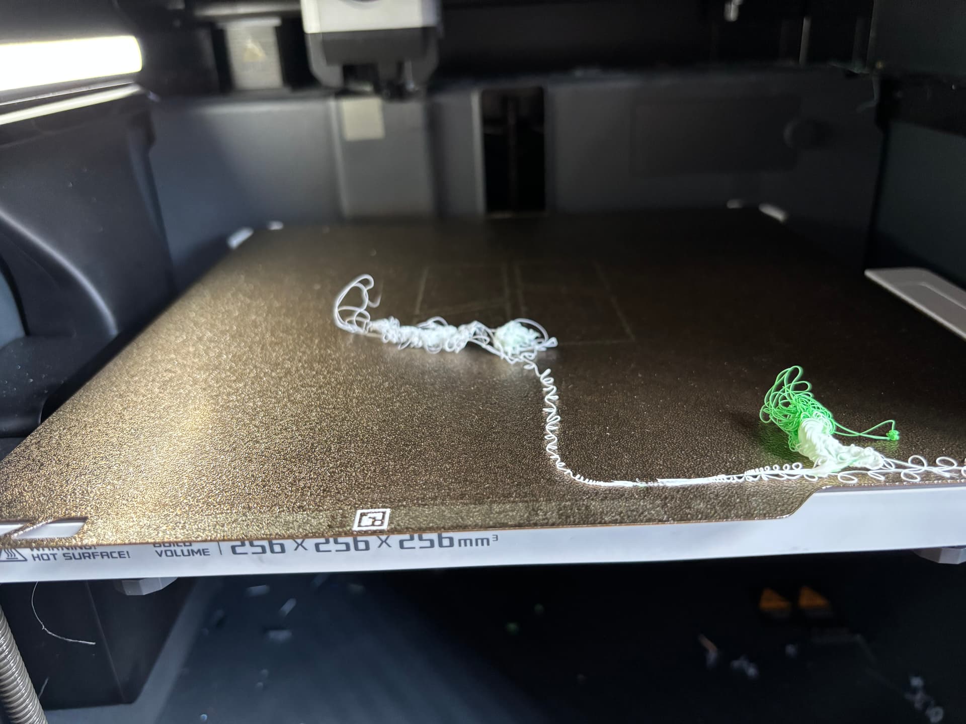

Hi guys, hoping someone can help me before I yardsale this printer. I bought it around December 24 and it was printing great until recently. It started with bed adhesion which I fixed with a glue stick and cleaning the plate. Then the prints got fuzzy? is probably the best way I could describe it, so I purchased a new nozzle, did the calibration, cleaned and lubed everything according to the maintenance video and it works ok for a while, but I would still get the occasional issue with a print.
Fast forward to about 2 weeks ago and I cannot get through a single print anymore. I am having multiple issues including layers not adhering to each other, the print head slamming itself against the back right corner so hard the head comes off, and what looks like the printer just forgot to print a section of the first layers. I’ve attached a couple of pictures of the errors as well as the calibration results.
I’ve power cycled the printer, checked for updates, cleaned and lubed it, replaced the hot end, and calibrated the flow rate and dynamics. My AMS says my filament humidity is at 25% and that’s pretty constant. I also looked through the forums but I’ve been unable to figure out what is going on with my printer. Any help you all could provide would be greatly appreciated.
The description of the print head hitting the corner hard, layers slipping, and “fuzzy” prints all sound to me like a belt has lost tension.
I’m new to Core XY printers too, having only used bedslingers in the past. That’s my disclaimer. But. Core XY printers have much more complicated belt paths for X-Y control than bedslingers, and the paths are much longer, which means losing tension is going to amplify problems fast.
Try retensioning the belts; instructions are in the BL wiki:

Thanks for the help, I tried the tensioning Wiki you sent and tried another print but it failed halfway through again by stringing like the first picture.

That is BL PLA?
Did you drag that plastic to the front or is that how it was when you stopped printer?
Trying to understand how it looks like the purge line it lays down across the front is still partially stuck to bed

I didn’t touch the line, or plastic. The only thing I did was hit the stop button after I saw the purge line fail. It does look like the end of the purge line is connected to the plate.

What I find puzzling is in that picture you see how it is loop after loop after loop?
The nozzle almost seems like it is too far away from the plate to allow it to do that.
There is a term in 3d printing called squish.
Here is Googles AI definition of Squish. I know what it is but do not know how to address it on a Bambu printer.
In 3D printing, “squish” refers to the flattening of the first layer of filament as it is extruded onto the print bed. Proper squish is crucial for good bed adhesion and overall print quality. Too little squish can lead to poor adhesion and layers not sticking, while too much squish can cause the first layer to flare out, potentially affecting subsequent layers.
When I saw that, I was thinking, “that is not right.” Your nozzle I assume is a .4mm nozzle. So, if your using the default settings it should have the layer height as .2mm.
Before your printer went south it should have been laying down that purge bead (a welding term I use for each layer) that was flat were it was mashing the bead between the build plate and the nozzle. You may have noticed that flatness when you would pick that purge line off the bed before it went south.
If you have ever watched a multi-color print swap color, it makes that ball of filament in the purge chute. It does that because the filament is not pushing against anything.
The plastic starts coiling up.
If I forget to change to the Super Tack plate when I switch from ABS to PETG, since it does not stick to the flat plate it will follow the nozzle over to where the print is, but it will still be flat because the “squish” is correct but the adhesion ain’t happening.
