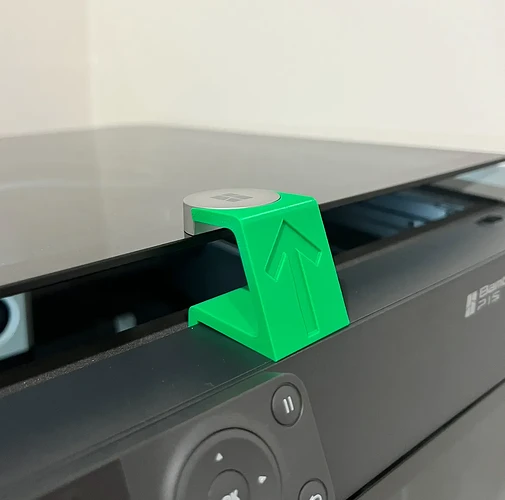

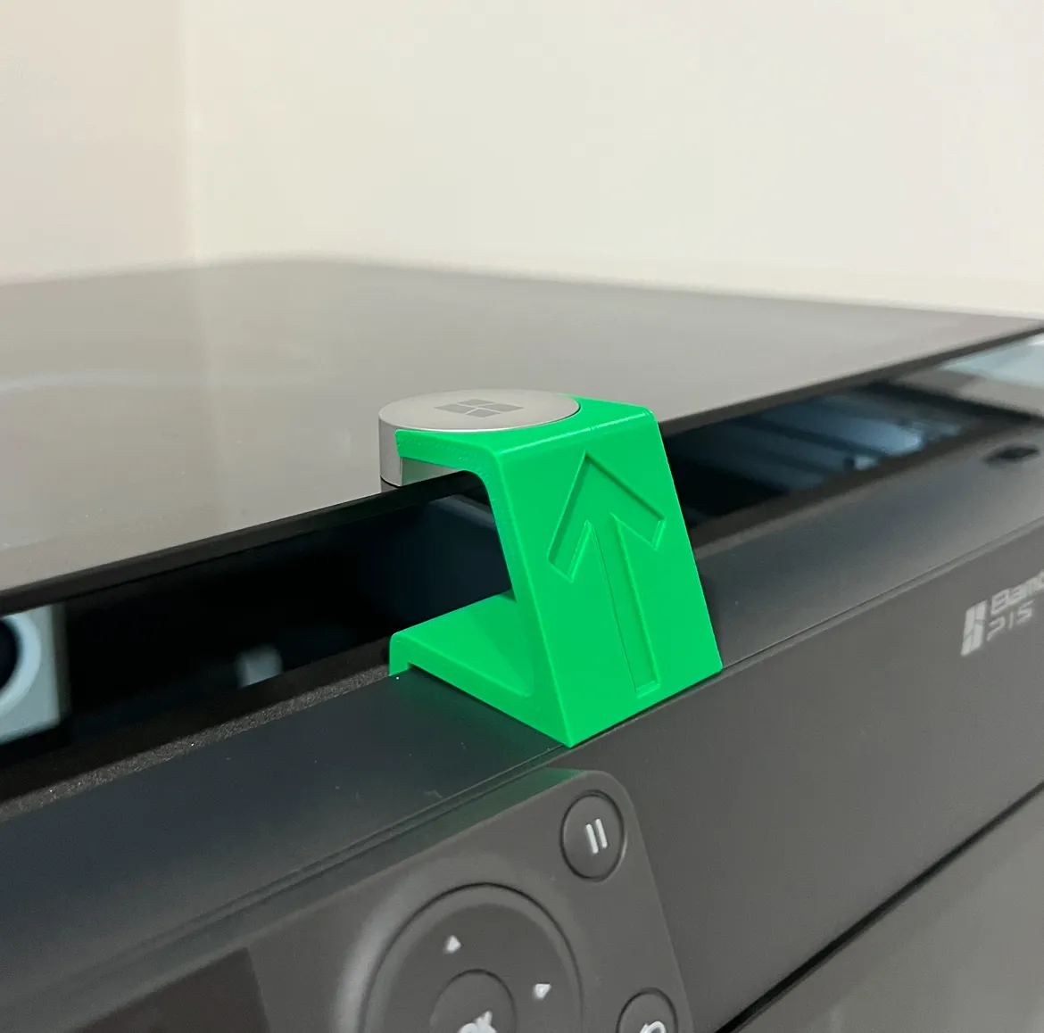

The printers that made PLA popular were mostly open-frame, which naturally kept temperatures low.
Enclosures make it possible to use hi-temp filaments (PC, PA, ASA, etc.) that require a warm environment and slow cooling. That can be a problem for PLA, PETG, and TPU, which need more rapid cooling. Door open/top off prevents chamber overheating.
Yes; and / or using a cold plate also helps to keep chambre temp down. Supertack works well cold; almost too much when you have a bazillion support trees you need to peel off.
(* And by cold i mean no heating at all past first layer, not 45 degrees cold)
I personally just use a little riser that I printed and it holds up really well even with an AMS and in PLA filament
