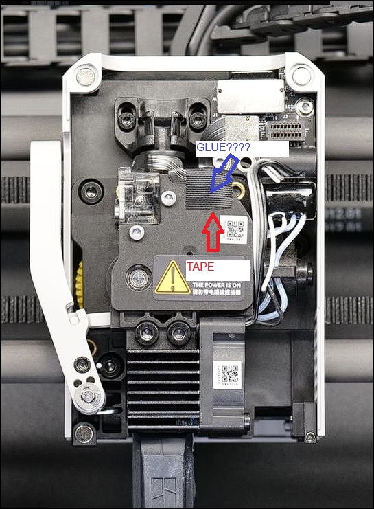

I recently bought a new extruder for my P1S. When it arrived it contained a small tube of “silicon” (their spelling) glue.
Here is picture of toolhead with the “As bought” tape in place. Do you put a dollop of the silicon glue back where the tape was to hold tiny ribbon cable to the extruder body.

I replaced my extruder a couple of months ago and had no problems that I remember with having to put tape back on to secure the ribbon

Recently I was really fighting with the toolhead when changing nozzles so wanted to pull extruder to see why it was such a problem. Figured I better buy another extruder in the event there is a problem with the extruder body causing trouble.
From that I got a grossly dirty extruder which I cleaned, lubed and reassembled. Then new extruder showed up with the tube of glue. Wiki has no explanation. I didn’t use the glue, but is is a cost item for BL labs and it even being in the box would imply a real issue. So the question is more “why were they sticking this tube of glue in the box?”
