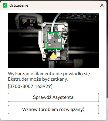

I’ve had this printer for about two weeks… well, technically, it has only worked for the first week. About a week ago it suddenly stopped working.
On the day it failed, I tried to print something, but the AMS started moving back and forth several times and eventually threw an error indicating there might be a clog. I disassembled the extruder but found nothing. Since I already had it open, I swapped the nozzle for a hardened one and cleaned the gears, but the issue remained. I even tried printing without the AMS, but the extruder still wasn’t able to pull the filament in.

Yes, I have tried loading without the AMS, but I got the same result — no success. At this point, I believe the problem may be with the extruder motor. It makes a clanking sound when I try to extrude.

I doubt it is the stepper for the extruder, the clanking or rattling noise is indication of step-loss which happens if the filament cannot be pushed into the hotend.

I have completely disassembled the extruder, but either I’m blind or there’s nothing wrong with it. When I tested it with the extruder outside, the filament fed through the gears properly. Today tech support told me they will send me… a new SD card. I was shocked… how should it help :smiley: You mean I should tear down the toolhead all the way to the motor?
Finally got the replacement extruder motor. Is there any video on how to replace it? I can’t find anything, and support just sent me the wiki for the X1C…
Dear colleagues,
Thank you for support. Replacing extruder motor resolved my issue.
