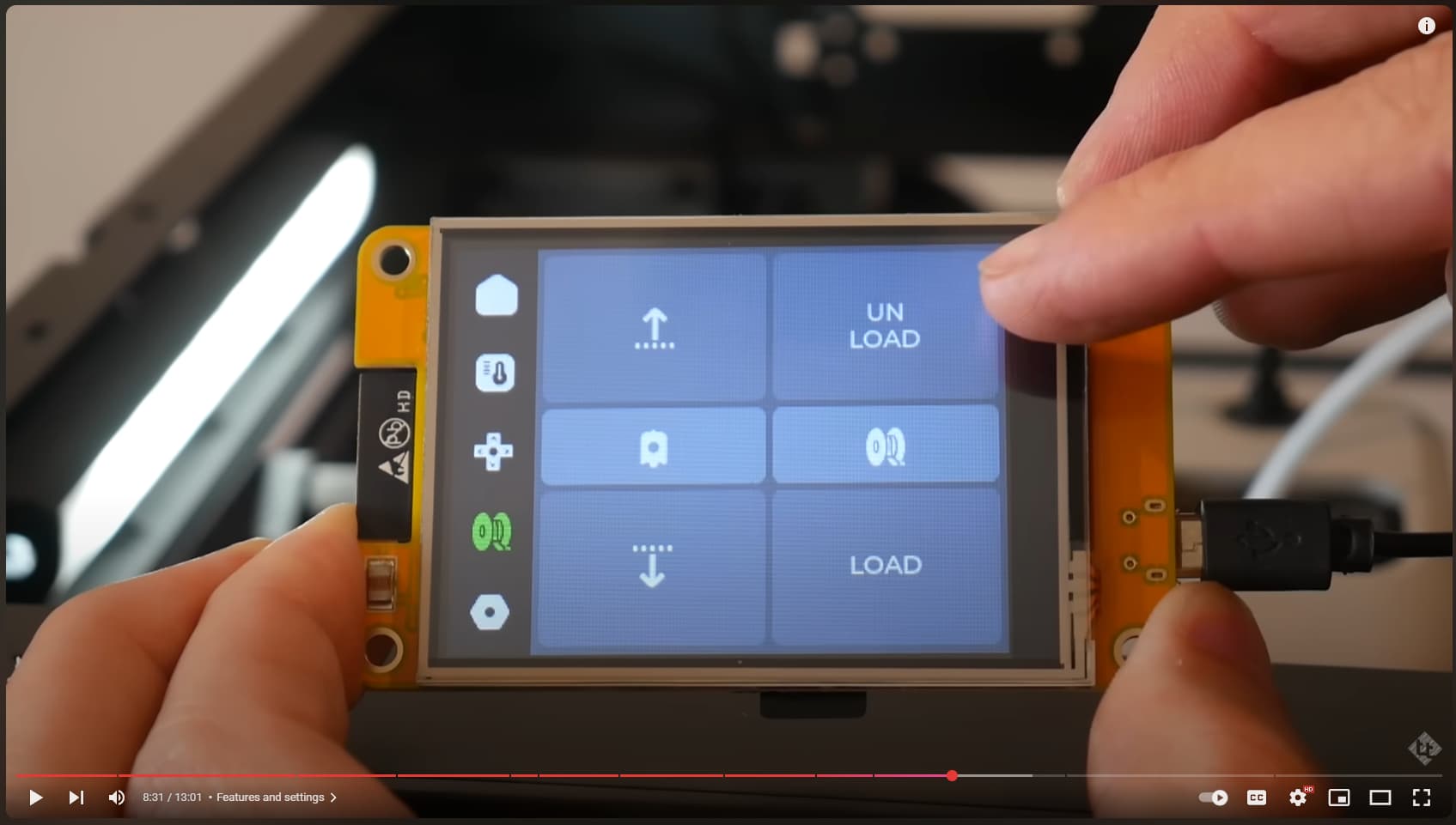

You can try xtouch

Im not sure if works with last firmware but i don’t prefer more displays :smiley: but thank you :wink:
