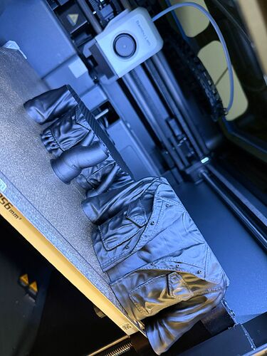

Hi, I’m currently having issues with my P1S+AMS, I’m trying to print with a 0.2 nozzle a 52hr print.
this is the second time it happens in different times/hrs. both above 20 hrs of the print.
Printer set up:
0.2 stainless steal
Bambu PLA Matte Charcoal feeding from AMS
Temps
*220/220 Hot end
*55/55 Bed
current issues:
No Filament coming Out
Extruder wheel its not moving
AMS its not feeding
and no Error codes on screen
The printer keep “working” like everything its ok but nothing its coming out of the hothead.
the Hot end its brand new, after my first fail, i tried to re do the print but that time after filament was primed from the AMS and purge line was completed, it start acting like “it run out of filament” doing this ghost printing. I remove the extruder assembly but nothing was found. after the inspection of the extruder I did some test and everything was looking ok, started the main print again and if failed after 24hrs into the print. Idk what can be causing this issue, please help!

To me it sounds like the nozzle is building enough pressure that the filament feed gears are grinding and indent into the filament. This would cause the print to continue but nothing to be extruded.

I did change the printer settings before. .2 due to the small details in the print that’s all. I literally just removed the extruder assembly and everything seems clear, the yellow wheel spins with no issues whatsoever and the motor also looks clear

How long has that extruder been in service? Admittedly hard to tell for sure but the metal serrated wheel looks worn. A lot deeper than I recall. Is the tensioner roller that applies pressure tight?

Maybe heat creep plugging nozzle due to length of print?

Extruded has been in service for 800 hrs and tensioner it’s tight. No build up on the nozzle while printing or any stringing from the filament. Every how often you should replace your extruder assembly ?
