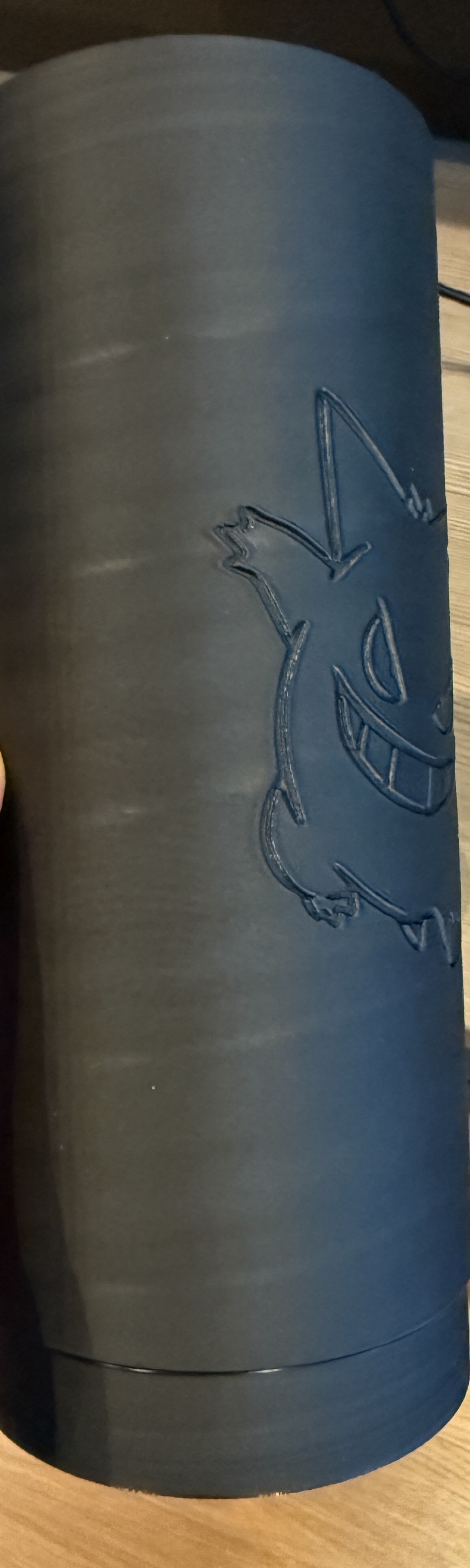

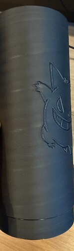

P1S is Ghosting or ringing out of nowhere?
My p1 s is suddenly ghosting or having ringing when it comes to printing. I have tried the same exact file and settings on my ither p1s printers and it doesnt seem to be appearing at all meaning there is something wrong with this specific p1s
I’d start by performing a full maintenance on that P1S (clean, lube, and belt tension). Also inspect the PTFE tubes, be sure the filament is not tangled at the spool and check AMS operation if applicable.
