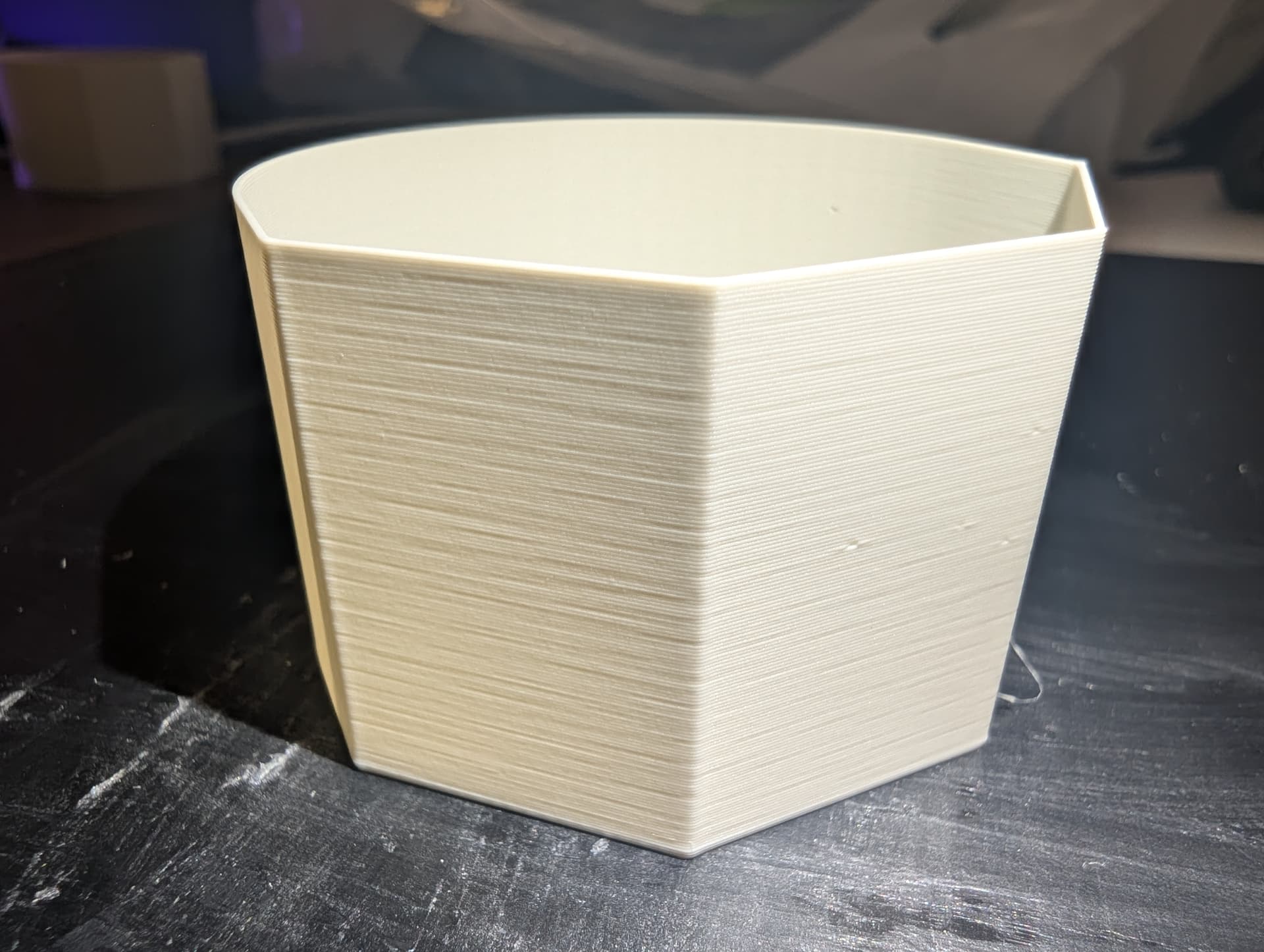

I am attaching a photo of my most recent test print. This is the best quality I have achieved so far.
It’s settings are:
Standard 0.2 BBL process + Bambu Matte PLA filament profile. Single wall, 0 top layers, Arachne, wall speed 40mms, acceleration 1000, nozzle 220C. filament diameter reads 1.74mm on the calipers.
I have been 3D printing for 12 years, so not a novice.However i am completely stuck on this one!
Here is an example of the banding. This is the best quality i have achieved so far with Bambu Matte PLA.
It has been dried multiple times at 50C in a filament dryer for 10 hours. (i’ve done this across 7 spools now and all had the same issue, so i dont think it’s moisture)
Process and filament settings in my original post above were used for this print.
Here’s the 3MF file too incase anyone wants to check the settings for anything obvious, or simply run a test yourself.
Black Panda test.gcode.3mf (46.4 KB)

I think i’m mostly interested to see if the Bambu printers can actually produce clean walls under a harsh light, so if you’re able to take a close up photo of a straight surface with a light shining directly down on it, that would be amazing for comparison.

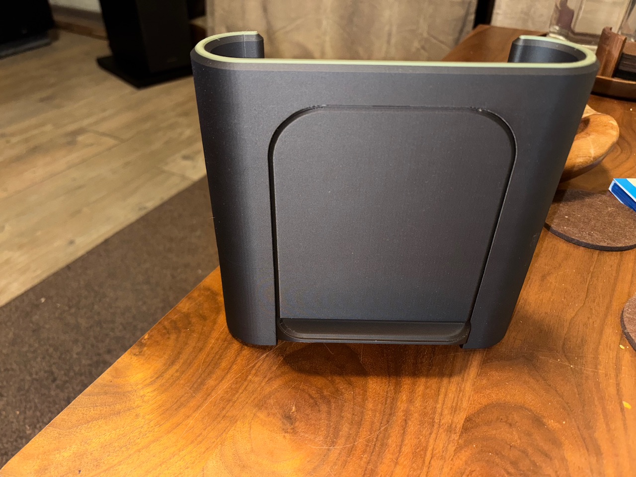

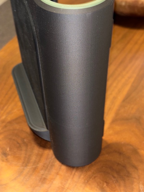

They shurely can. I would contact bambu support , heres a shot of one of my models, printed in shown orientation, 0.28 pla matte

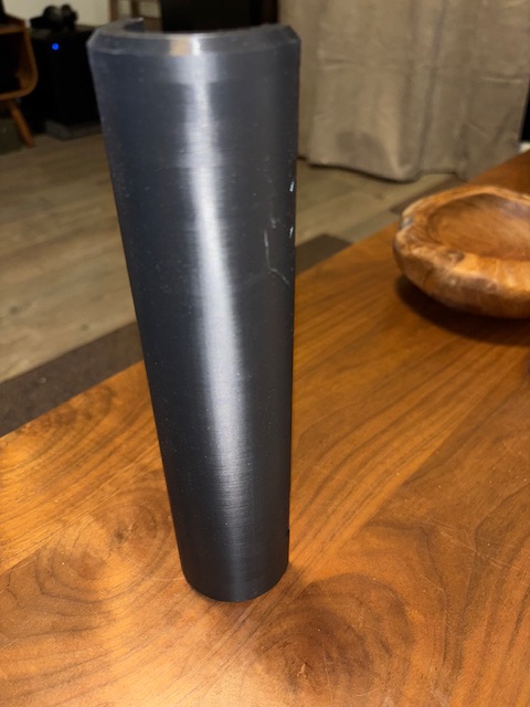

Heres the worst i could do, bambu pla basic 0.28 with flashlight
Ok, i overread straight surface… here

My models where printed with a very much out of the box p1s with default settings. If its pretty much worse than this from the beginning, i would think your printer has some serious problems and its a support case…
