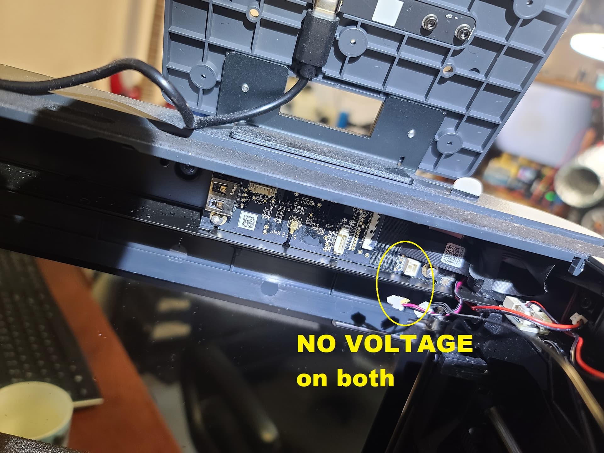

Able to use bambustudio but LCD is blank
Cannot turn lights on using bambustudio.
Something is dead and i dont know what.
I do have LED strip connected to the board that i bought on amazon. Maybe thats what causing power issues to the LCD ?

i only had LED strip>
Disconnected that, no change.
No voltage on the breakout board.
Resistance is mega ohms on both board and LED strip.
Where is the origin of the voltage on that breakout board ?
I guess what i am asking is: since the beakaway board is part of the LED strip mod, where does the voltage come from that powers the LCD ?
The BIGTREETECH lcd is powered just fine and i dont really understand why that works but original LCD does not. Are they not on the same power rail ?

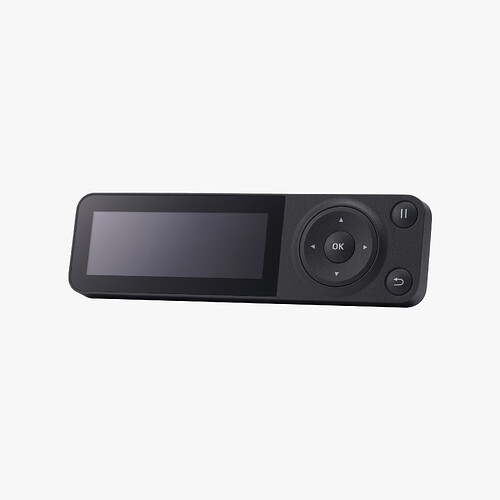

One important clarification: the BIGTREETECH Panda Touch display does not validate the printer’s internal LCD hardware. It connects to the printer over Wi-Fi (MQTT/network control) and is completely independent of the printer’s built-in LCD, ribbon cable, and backlight circuits. Its ability to work only proves that the printer boots and communicates on the network.

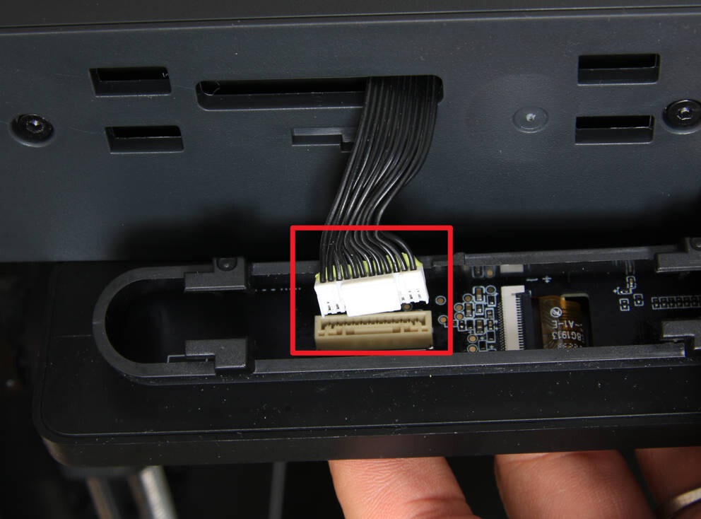

  1. Power the printer down and re-seat all LCD-related cables, especially the ribbon cable connecting to the LCD. Inspect for bent pins, partial insertion, or visible damage. Taken from the Wiki:

The wiki on this is pretty good, especially the YouTube video.
i cant get tat LCD out. its glued ?
It sides to the right to remove.
You put it on when assembling the printer so it shouldn’t be glued.

there is no power with or without the LCD that would go to LEDs strip.
0v whats so ever.
Does that mean LCD is dead and does not generate voltage for the LED strip or what ?
I am not sure the source for LED lights to get their voltage from.
Its connected to the board directly behind the LCD so i would image that board is dead or what else ?
It is not glued. The LCD is friction-fit and intentionally tight so it does not work loose due to printer vibration. It is designed to be hard to slide out. Use firm, steady pressure and slide it straight out - do not pry or twist it. Be careful not to snap it. Once it starts to move, you can pull it forward to fully disengage it.

Never mind. After reseating the LCD cable, everything started to work MAGICALLY.
