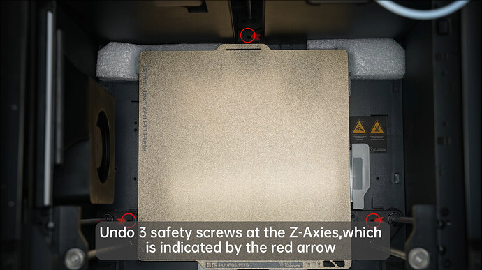

Double check that you removed all of the screws holding the z axis down for shipping.
Solved that issue. Now have 0700-7000-0002-0003 error, apparently a nozzle clog? Not impressed with the P1S so far.
