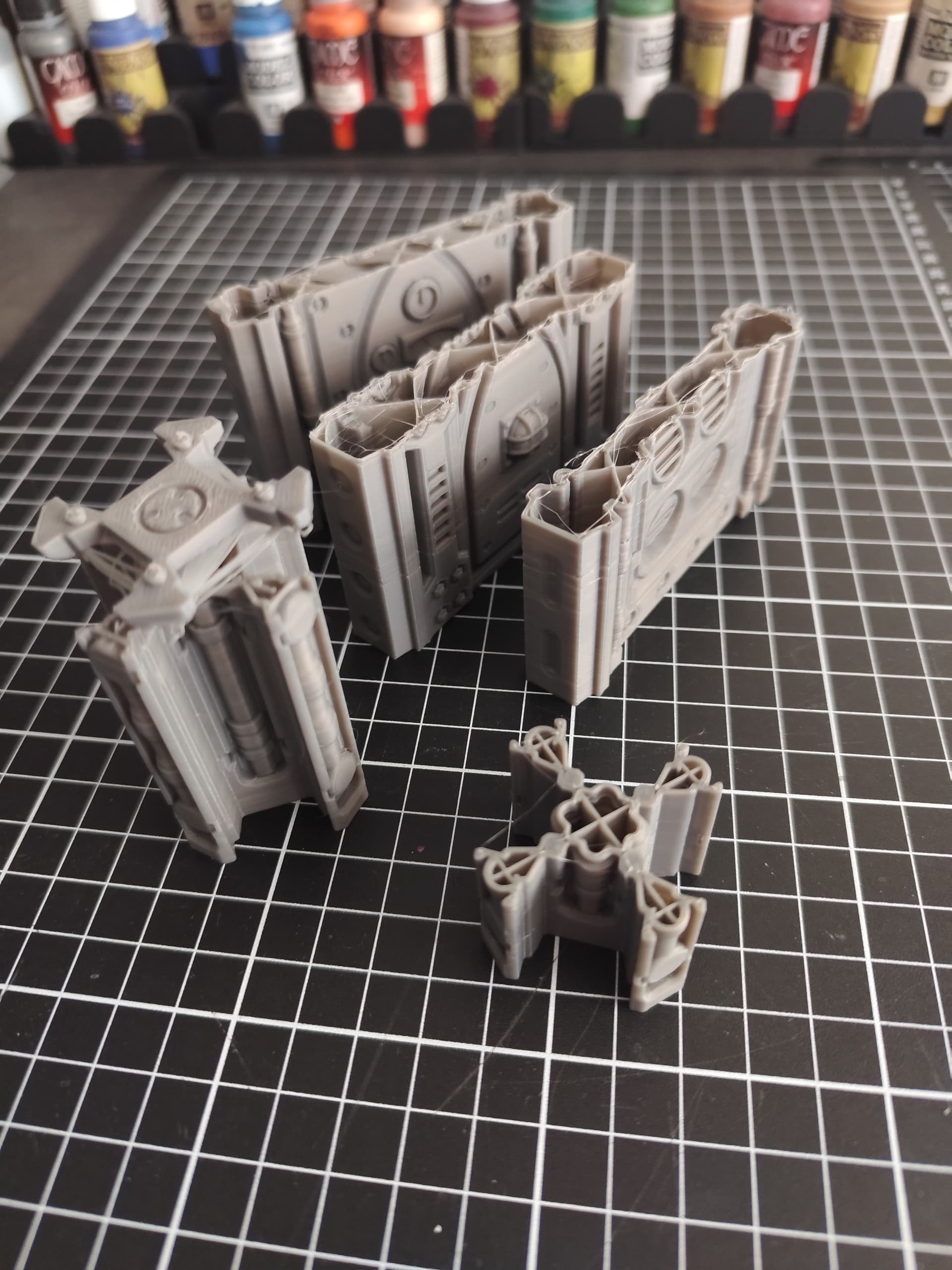

All of a sudden, after 18 months excellent printing, my stock P1S now fails every print (see pics). It looks like an extrusion issue or clog, but I can’t find the problem - Any suggestions what I can troubleshoot to resolve this problem?
What happens - Prime strip or first layer sometimes come out patchy OR most of the model prints, but misses a layer / stops extruding entirely.
Here’s what I’ve tried so far - am all out of ideas:

You may want to try a factory reset on the printer. It has worked for others with odd issues like this.
Replaced extruder?
No, but I did entirely dismantle and inspect it - Couldn’t see any visible issues, wear or PLA fragments.
I’d replace the extruder assy and even potentially the extruder motor, but those are spares I have sitting here.
Any chance you changed what is was sitting on, like to shag carpet or squishy foam (don’t do either!)?
Otherwise maybe flip it over, grab the z belt and drive it up and down a bit and make sure it is smooth.
Just completed a factory reset and calibration - Sadly the prints still fail
I’ll have to look at ordering some spares - Nothing changed when the faults started. it’s been great for over a year until this week.
Since you tried all the mechanical avenues, have your tried reformatting your SD Card? This would not be the first time that a few bad sectors on an SD Card was causing the printer to exhibit behavior like this especially if it were happening all of a sudden. At any rate, it takes two minutes to format your card using the P1’s menu and it will at least eliminate that as a possible cause.
Olias has a great idea too, except I’d just replace it.
I’ve just replaced and formatted the SD card - Still failing :frowning:
Sadly didn’t work with a new, formatted SD card
Did you flip it on it’s side and try moving the z belt? Also examine tensioners and pulleys and motor shaft. (turn it off 1st)
Extruder or ptfe in my opinion. If you try a model with no retractions it would be interesting. Vase mode a small something.
