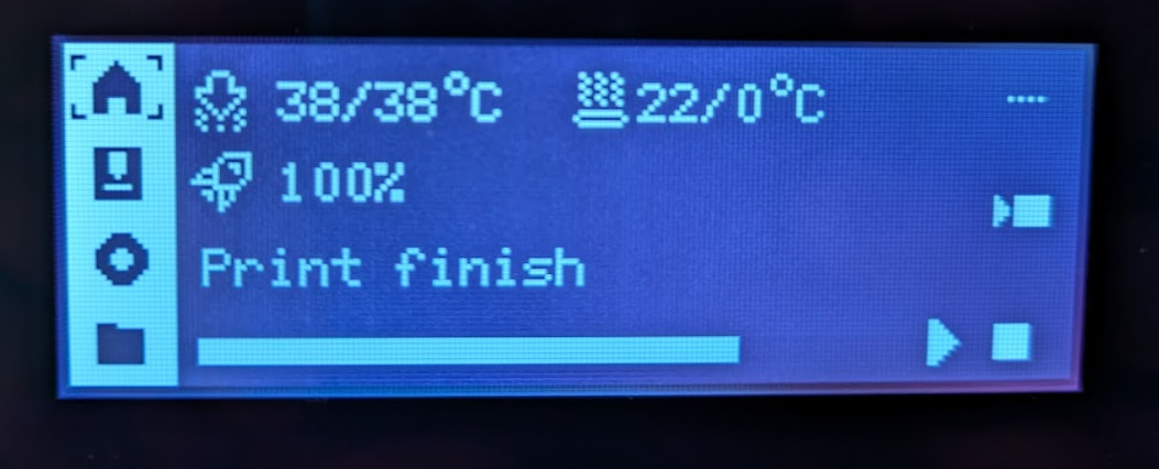

P1S: Nozzle not cooling down bug
After manual unloading and loading: Nozzle SET temp and actual nozzle temp stays at 38°C.

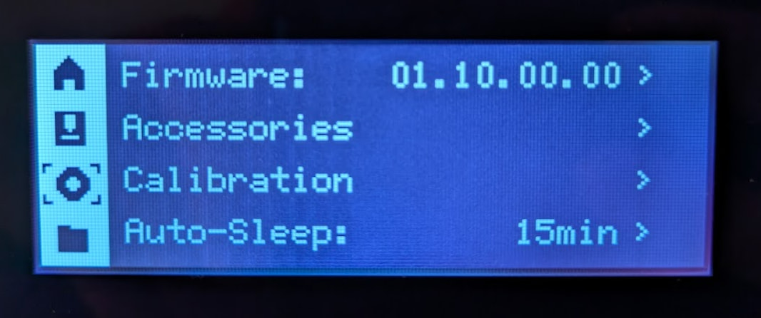

(Did not use Handy or Studio but they are also on latest versions)
Sorry I misread the temperature. I’m trying to repro it now.
Why? 38°C is way above any normal “room temp“. It should be turned off when idle.
Mine is staying at 190 right now after just an unload/load. Any chance you did a load/unload?
With rounding, it converts from exactly 100°F. Did someone (from the US perhaps) miscalculate something?
190 for a few minutes then right down to 38 and stays there. Just checked again now. No AMS on this one.
