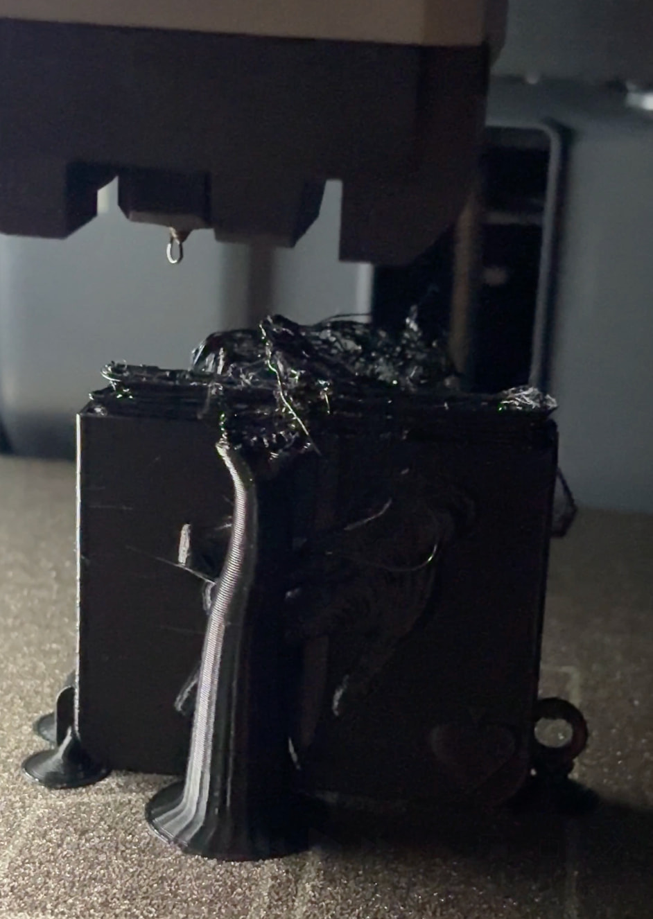

Bambulab P1S print issue how to identify cause of the issue? Seems like a bit of ghost printing ? over extrusion ? idk how to fix this and have been facing it for a week now, hope someone can give some advice ! thanks!
you should post an image of the STL file, so we can see what it should look like. with the tree support going up the side, looks like there is an overhand to support. Also, is there an interior on this model?

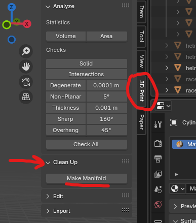

I have found that if the geometry is ‘funky’ that it could cause odd behaviors on print. I have seen some objects I created appear ‘darker’ on the print bed, which indicates it might be inside out, or non-manifold. I use Blender, and now often use the make manifold option from the 3D Print (free) plugin.

Are you able to post the .3mf file of the part you are having issues with?
There’s a template for the information you should be providing when asking for help, please include all that information. We’re just guessing without it.
