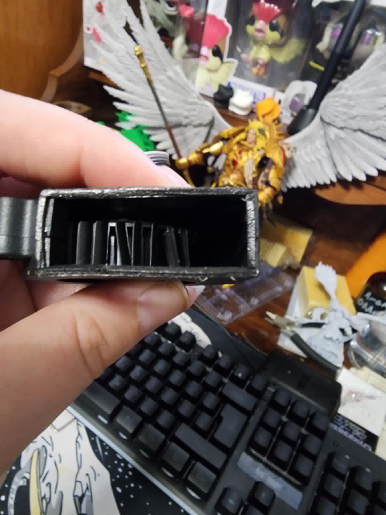

P1s toolhead fan sheds mortal coil and sounds like jet taking off

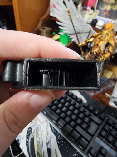

I don’t know what caused the fan to fail so spectacularly, but there it is, chewed up like a piece of scrap through a grinder. Thankfully, I can find parts. Annoyingly, those parts cannot be found on the Bambu site unless I’m a blind trogloydite.
WOW thats some fail there
The only way to get it through the Bambu store is to buy the whole front housing assembly.
You can get the fan only, with the correct plug on Aliexpress. If you’re in the US there’s also a store in South Florida that has the same wide mouth fan but you will have to solder the Bambu plug on it:
When did it happen. :grinning: I hope you find your parts for cheap and quality. Good luck :wink:.
thank you so much that beats 35 euro for the same brand same part as comes with the printer originally.
I think the initial frog in a blender moment happened a few months ago now when the front cover flew off the toolhead out the door, without breaking it somehow, and landed on the floor of my office. then it was a series of the front cover just flying off. I just never noticed the issue till I tried to print something this morning and the thing took off.
