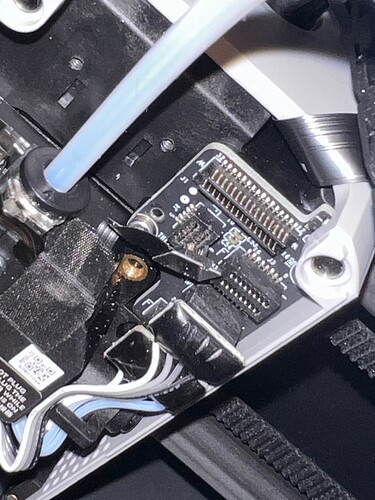

My P1s stopped extruding half way through a print today and a grinding noise in the toolhead.
I raised a ticket with Bambu (my first) ref this.
This evening I removed the feeder and nozzle, the nozzle was blocked solid with filament .
The feeder was also blocked as it had ground away the surface of the filament.
I cleared the feeder intending to warm the nozzle to 265 deg C then push filament through to clear the nozzle.
Re assembled but nothing.
I opened the toolhead cover again and noticed one of the plugs had fallen out of its socket, I pressed it in again and it now just falls straight out.
So my question is which part do I need to fix this/
The plug is the one for the small ribbon cable leading to the left top side of the feeder - pics attached.
Any help appreciated
If it’s the cable, that comes with the replacement extruders that Bambu sells. Very easy to replace, only 3 screws.
If the issue is the plug, you can replace that as well. They sell an extruder board and have a walk through on replacing it. Just take your time and do so mindfully and it’s not a hard job to do. Might take at most an hour.
That is the filament sensor plug. It probably got pulled out when you were removing the clog.
If it won’t stay in it’s plugged in wrong. If you look at it closely you’ll see that it has to be plugged in so each set of pins goes into the female equivalent on the board. It snaps kinda. You’d have to work hard to break the pins or connector. The ribbon cable breaks first.
If it is broken just purchase a filament sensor from Bambu store. Not expensive. I’d be surprised if it is broken.

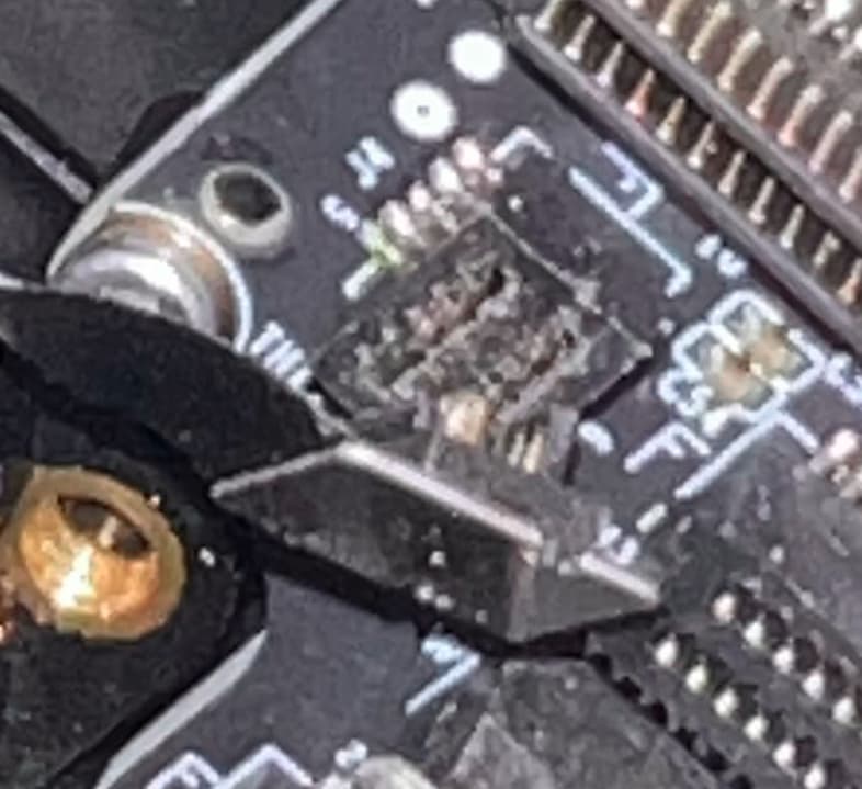

Looks like dust or debris is in the socket
Can you take a closeup of this section using Macro Mode on your camera.
If what I am seeing is the case, that PCB connector looks pretty chewed up and would necessitate a replacement of the extruder interface board. Here is the link but wait to see what support comes back with.
This is the connector that would help if you could get a closeup photo.

Try cleaning both sides of the connector with isopropil alcohol and a brush. It looks like it¡s full of debriss so the two part don’t plug properly.

In hindsight looking at the close up of the plug it appears that a small pice of the insulation shroud on the top eft pin is missing, the copper is clearly visible on the left but covered on the right!
I am thinking maybe this plug has failed and popped out and been part of the failure.
Ordered the new part already, will update when done.
