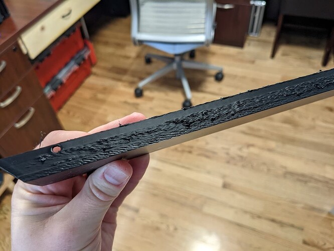

I am trying to print this model on my P1s, but one of the walls looks like this (on the outside and the inside):
This wall fails:
The other long wall on the opposite side of the model looks perfect.
I am using the print settings from the model. I have tried recalibrating the printer twice. I am using Bambu Basic PLA.
What is causing this?
I took a look at the 3MF file and the model appears to be fine, so it’s not causing your problem. Gyroid as infill, etc. – everything looks good. I would just maybe set the wall thickness to at least 3 and switch to an inner/outer/inner wall configuration. But these are only minor optimizations, not really significant.
However, as I said, this has nothing to do with your problem. I’m just mentioning it because I have the file open anyway.
So, let’s get back to the problem. I would take a step-by-step approach. Could the filament have become too moist? Do you have any other filament that you could try using? To avoid wasting filament, only use a small cube to print.
It could be that your print was also affected by warping at that size, meaning that the object bent slightly upward on the side. You should always make sure that the printer plate is clean. A brim can’t hurt either.
In the photo, it looks as if the first layers already have problems, then the defect naturally spreads upwards.

I do not think it is the filament as I am using an AMS with desiccant and finished several prints just before this that all turned out perfect.
I always clean my plates with alcohol between prints and with dish soap and water after every 5 or so prints.
I will try with a brim and see if that helps.

Just an observation. The wall that is failing is the one that is next to the large cooling fan in the printer. The fan could be causing that wall to move. You may want to reduce or shut off that fan and make sure to have your lid and door open.
Another option would be to add support for stability.
I created a test model, a long thin box. I have printed it twice now and both times it came out perfect. Something must be up with that first model…

i would say try drying your filament. it looks like a moist filament problem.
I had the same problem on my P1S. The solution was to manually level the build plate. The procedure is in the WIKI. After this, I ran an automatic calibration. I printed perfectly after this.
