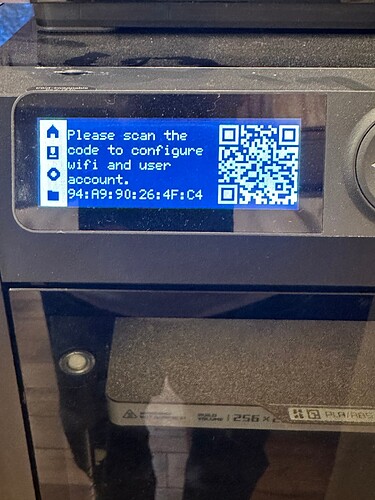

I changed my WiFi password today, and now I am completely unable to bind my P1S printer. None of the options for binding work:
  • PIN Code - I cannot bind with a PIN code because my printer will not show one. When I click on “Account” where the PIN code is supposed to appear, I get a QR code that tells me I have to use the Bambu Handy App.
  • WiFi - I cannot enter a WiFi SSID or password. As with the PIN Code above, it shows me only a QR code that tells me I have to use the Bambu Handy App.
  • Access Code - I cannot bind with an Access Code because I cannot login via WiFi (see above).
  • Bambu Handy App - When I scan the QR code to bind using the Bambu Handy App, it gets to step 2 of 4 and fails, telling me “Failed to request the printer’s WiFi list”. But, I can’t enter a WiFi SSID or password (see above).
  • Manual Config of MicroSD Card - I have followed the steps of manually creating a “user_wifi.cfg” file on my MicroSD card with the SSID and password of my WiFi. I’ve done that; the config file is there, but it does nothing.
  • Factory Reset - I tried doing a factory reset, but that didn’t help.
I’m out of ideas. I’ve searched the forums, read and followed everything I can find, and still can’t connect to my printer. I can see the printer in Bambu Handy, but it won’t connect.

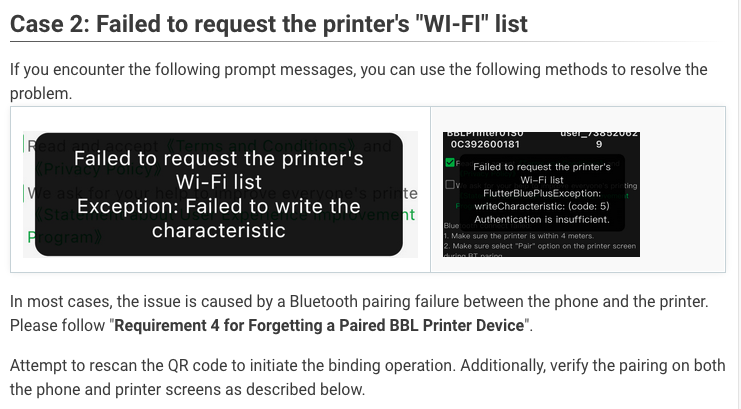

It always fails at this Case 2 of this troubleshooting guide:

Part of the problem is that the information that’s supposed to show up under WLAN doesn’t appear (. It’s supposed to show me a list of available network SSIDs and/or a PIN code that I can use to connect. Instead, it just says “Use this QR code with Bambu Handy to set up your printer.” It’s been about 8 months since I first set up this printer. There’s no IP address because it’s not connected to WiFi. I’m not able to enter an IP address either on the printer or in Bambu Handy.

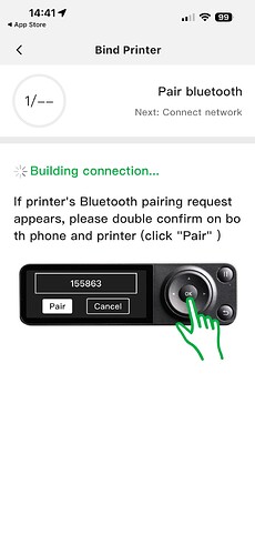

I figured it out. I was pressing “PAIR” on the phone, but not on the printer. :roll_eyes: At one point yesterday, I actually tried pressing on the PAIR button on the printer screen, but it’s not a touch screen, so I figured that it only needed to be done on the iPhone!
Man, do I feel dumb. Hours wasted for nothing. Maybe I just needed to sleep on it and read the instructions on the screen with fresh eyes.
