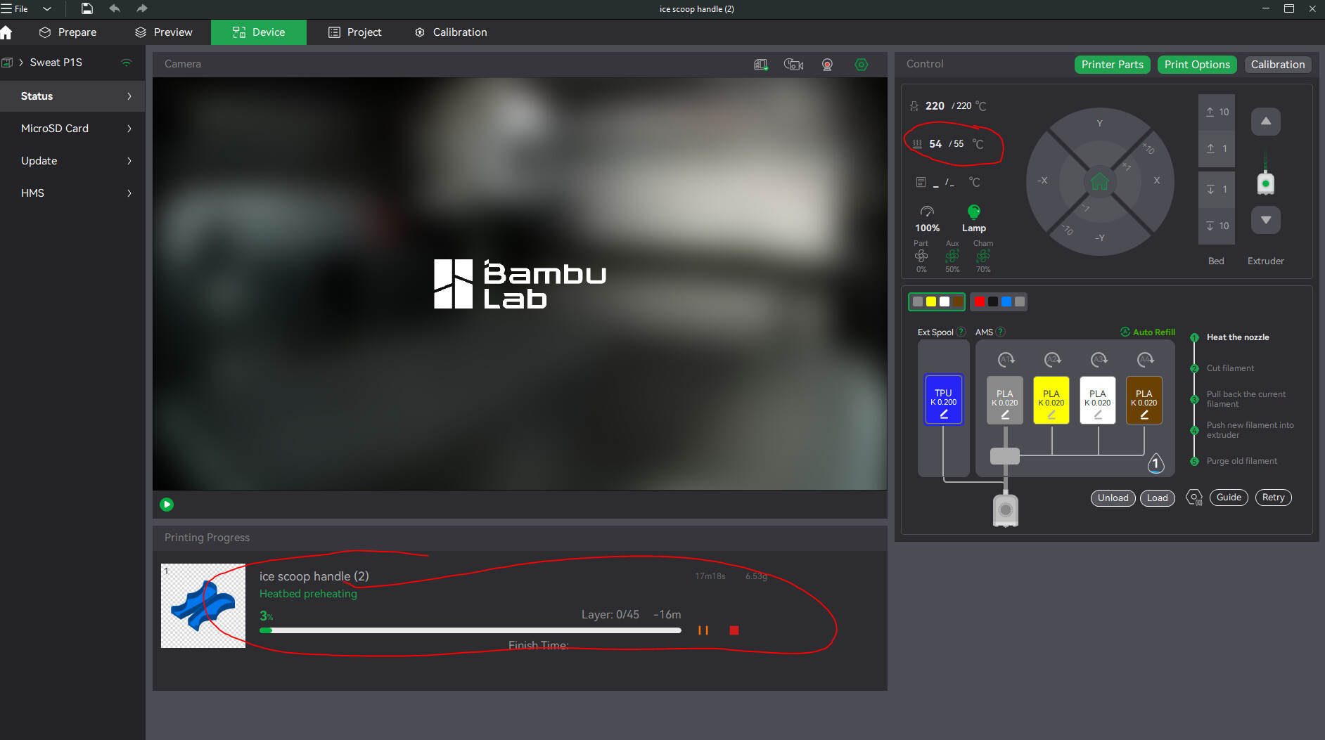

P1S wont print after 01.08.01.00 update
it just sits over poop chute and says
temps seem fine heatbed is 1 degree lower than setting would that matter… I have tried formatting sd card and even putting in a new one formatted so that doesnt seem to be an issue…if i roll back it works fine but this version just bricks my p1s
it appears the issue was i was using BS v1 and it wouldnt let it work for whatever reason i was hesitant to upgrade to BS 2 as i read lots of issues with it, but the firmware upgrade “nag screen” was annoying me so i bit the bullet and upgraded to BS 2 and then the firmware seems to have worked… so far so good on first print… hope its not regretted…
