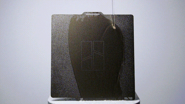

Please check out this article, for more information about how to clean the plate.
It includes two gifs that can help you understand if the plate is clean or not.
  • Before cleaning, the water on the PEI plate flows down in streams and gathers into droplets, which indicates the adhesion of the plate is poor.
  • After cleaning, the water flow on the PEI plate forms a thin water film, which indicates the plate has good adhesion.

the 2 GIFs are actually very useful tips for me to verify if the plate will stick before setting the printer off again! this serves as a very good indication (instead of having to set off a small print and wait for the printer to initialise, which takes about 7 mins each print)
great help thanks!

someone in this thread recommended me to try different kind of soap when cleaning it and that helped me to set the printer off again,
the bambulab support assistant has then taught me how to look for signs of wheterh the PEI plate will stick before starting the print, see above.
