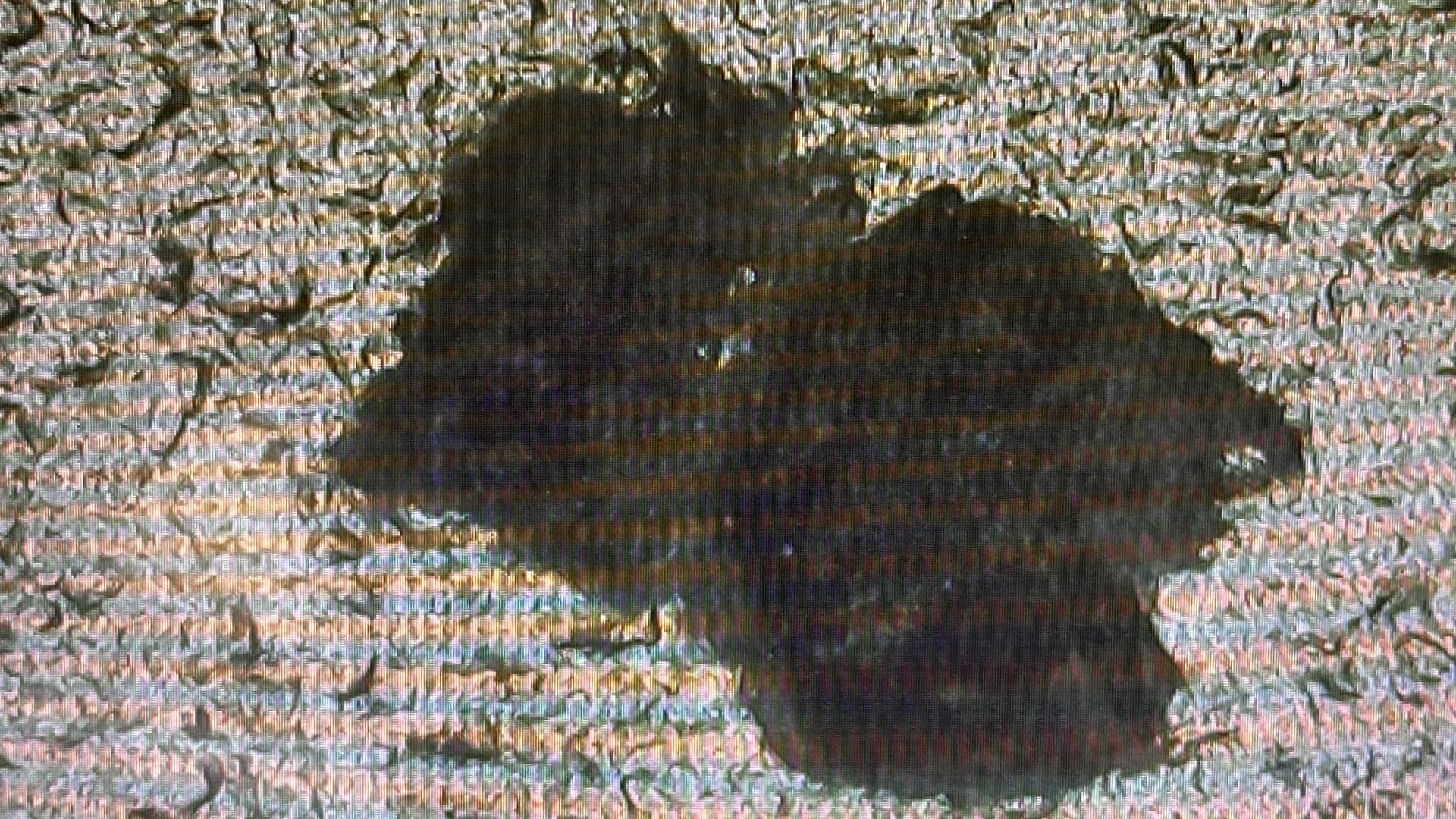

I took the extruder fully apart and noticed there is a thing that appears to spring back when the filament is removed. I found a bunch of what looked like to be fluff in this jamming it so it would not spring back into its normal location.
This was reassembled and no more filament in the extruder message. I have no idea where fluff would have come from after only 3 days of printing.

I found this which shows the sensor can be taken apart further
On inspecting mine further taking it fully apart, I saw the fluff wasn’t fluff at all, its plastic.
There is a hole in the side and a bunch of plastic has frayed getting stuck between the sensor spring mechanism and the closed gap for the filament path.
It was also all around inside where the filament goes. Thats why I thought it was fluff.
This is on the underside of the sensor so its not even like something coming down from the top could have caused that. It looks more like manufacturing defect.
I wonder if this is what was causing the tension errors. I used a knife to try and cut/scrape it out and the filament has loaded now.
Some of the scrapes are from me getting the previous bits out to try and make it close.
It was making the hole for the filament too small and trapping the sensor.
This is the screw coming through. If the bottom screw is done up too tight it comes right through impacting on the movement of the sensor.
Since scraping out that plastic and putting the bottom screw in half-way, all the other issues appear to have stopped.
I haven’t had any filament load issues or any tension errors.
