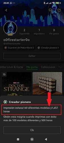

I can’t help you with the AMS 2 wiring issue, but regarding point 5 (printing hours), to see the total printing hours in the Handy app, I do the following:
Go to your profile and click on the creator badge; it will show you the total printing hours.

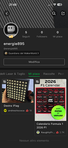

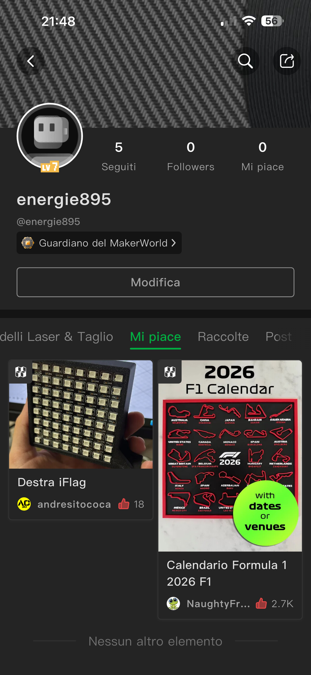

Thanks a lot for your message. But I use IOS and I cannot see this option :pensive:
The creator badge appears after printing more than 100 models and exceeding 500 printing hours.

This is the answer, as the creator badge does not appear if you print something from printer storage, so only cloud prints count towards the badge apparently
