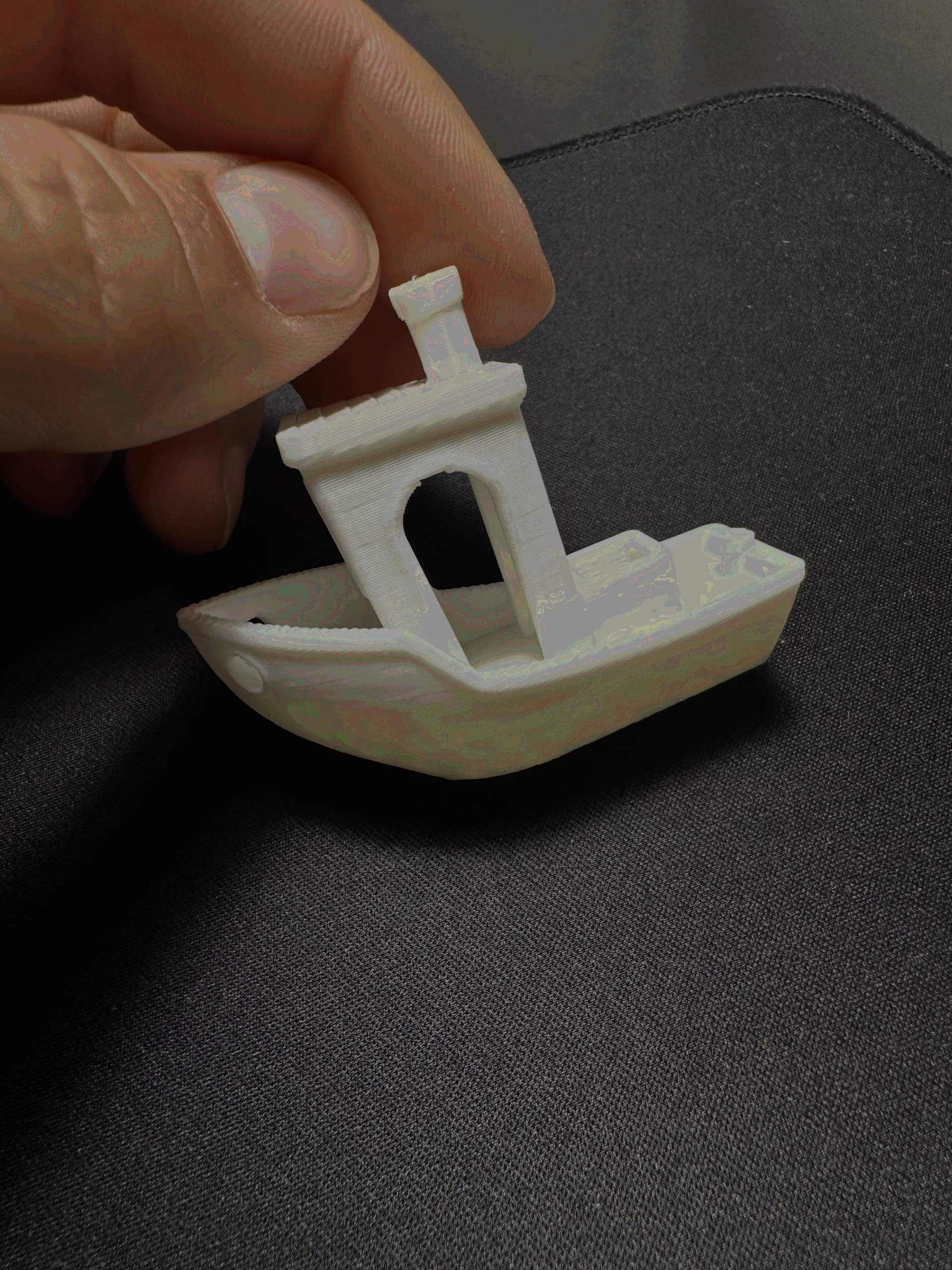

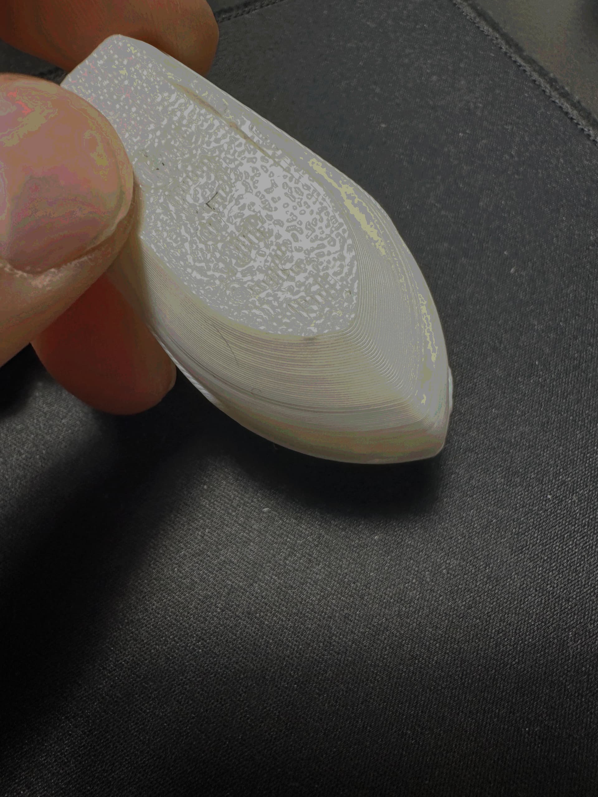

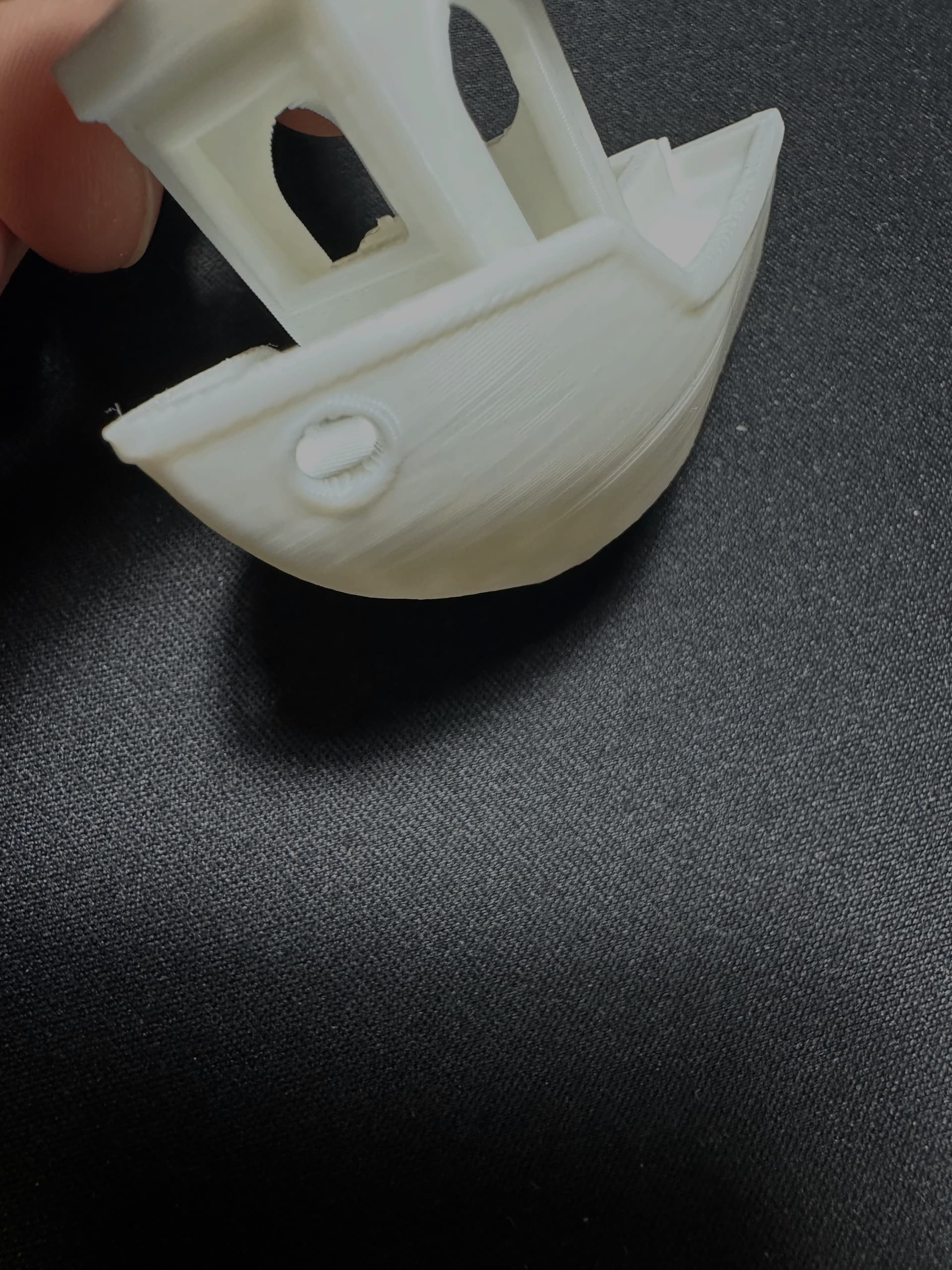

Hello, I have my P2S from like 4 days and till the first print I wasn’t able to get a good looking print. The white print are done with Bambu basic pla, dried in ams2pro and it’s like around 19/20 % of humidity but I always get that ugly ringing/banding (I don0’t know how to exactly call that) in every print, even with the benchy that is already saved on machine so optimized for printing with p2s. I don’t know if it’s a belt tension problem, or if there are structural problem in the chassis of the printer.
I think that there are problem with the bed too, the bottom of the benchy look too squished.
I can’t imagine that a new printer comes with this bad print quality.
Are there anything that I can do to reach a quality worth of bambulab printers ? I’m really heartbroken by this.
Does anyone have the same problem or have managed to solve that ?
Welcome to the forum.
Your print quality isn’t bad at all. This is what should be expected for 3d printing. You should be able to get a slightly better surface finish by manually calibrating your filament but you will always see layer lines.
Thank you for your answer, but some layer lines are are further inward than the others, and when alternated they give an uneven effect to the wall. When you run your finger over them you can feel them.
Is your printer on a rock-solid, level foundation or on a table?
On my printer this happens if I touch the printer while it is running.
My printer is on a furniture piece that without counting all things inside weight around 100 kg, it’s very solid

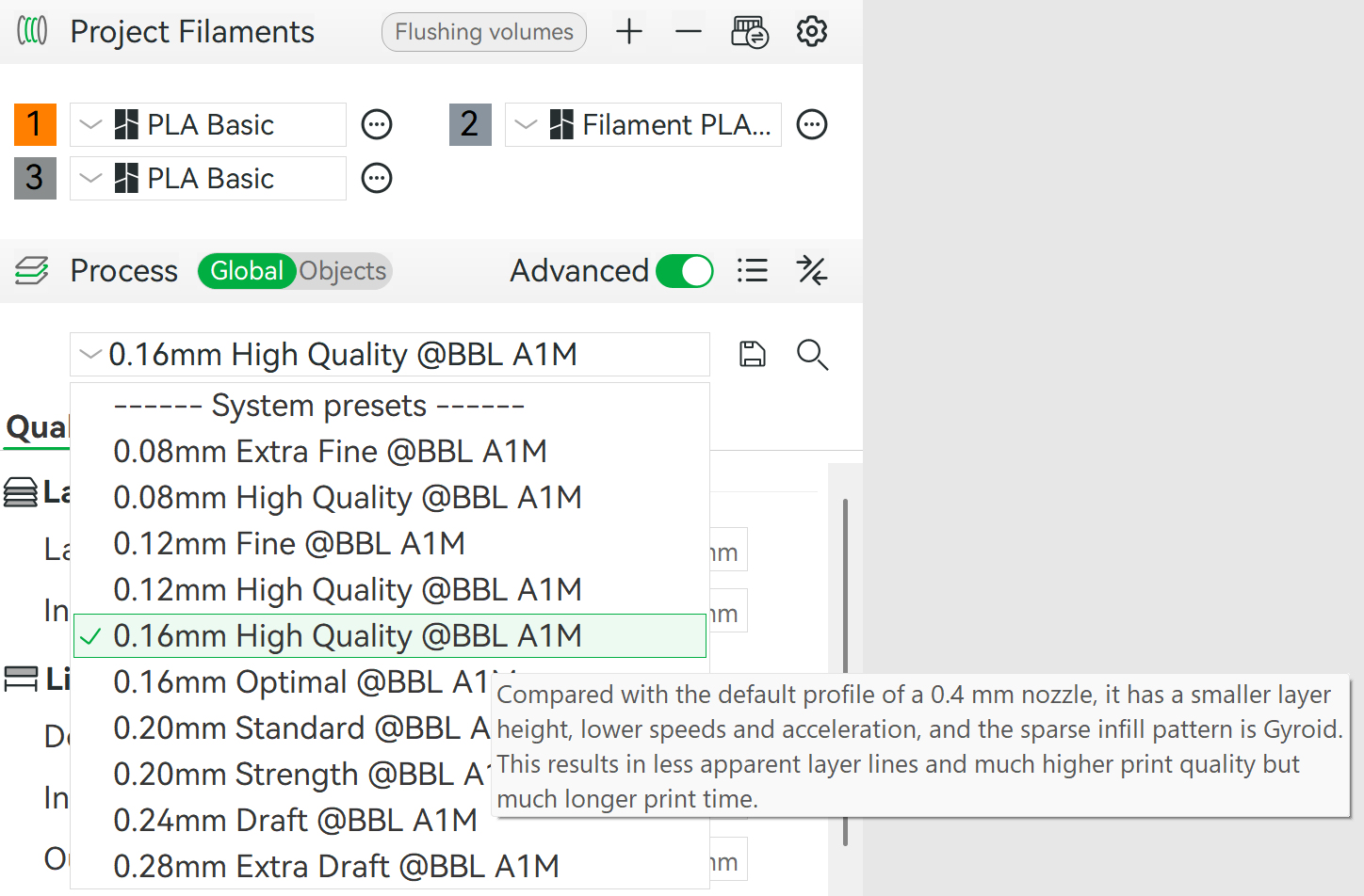

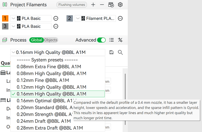

A note: The 3D models stored on the printer are not optimized for quality, but should rather be seen as a benchmark. We had exactly the same discussion a week ago. But no problem, I’ll summarize it briefly for you:
Download 3D models from the MakerWorld website and import them into Bambu Studio on your PC. There you can make a wide range of quality adjustments.
Bambu even has its own portfolio with 3D models:
Then, as mentioned, open it in your slicer/Bambu Studio and select a quality setting. There you will also find some helpful tips on what might work best.

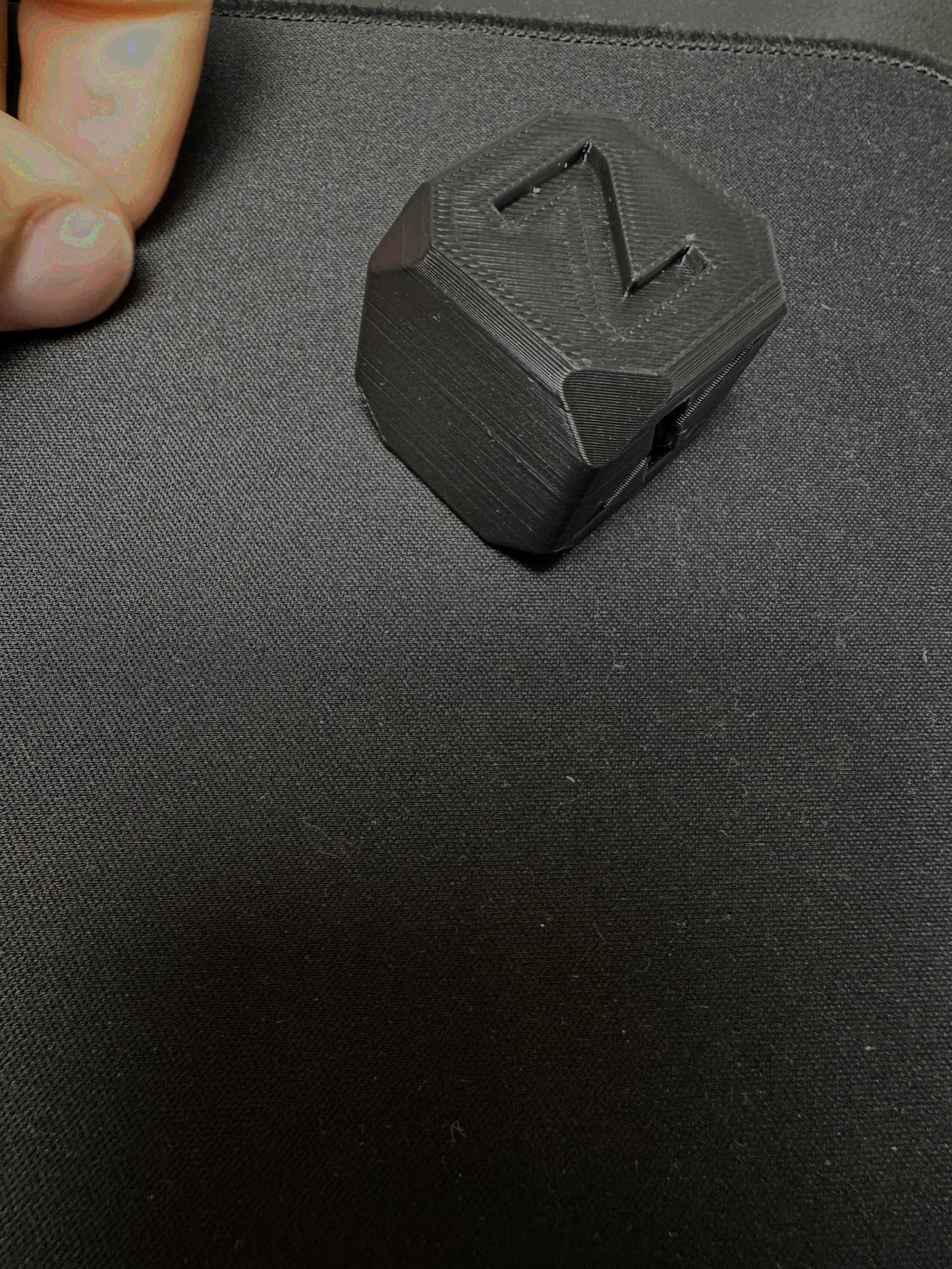

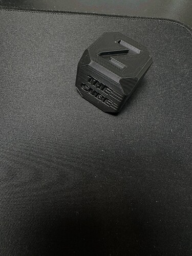

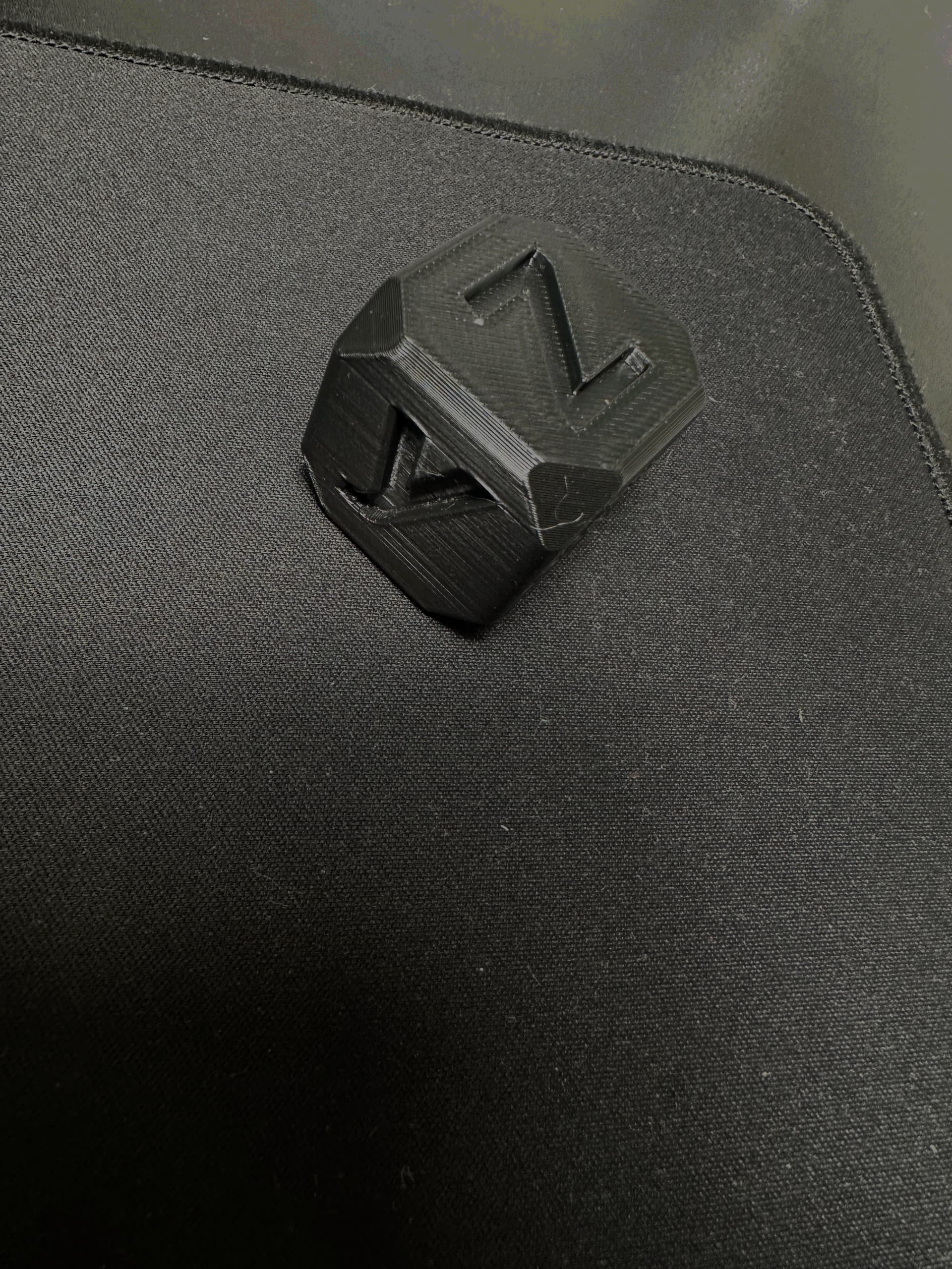

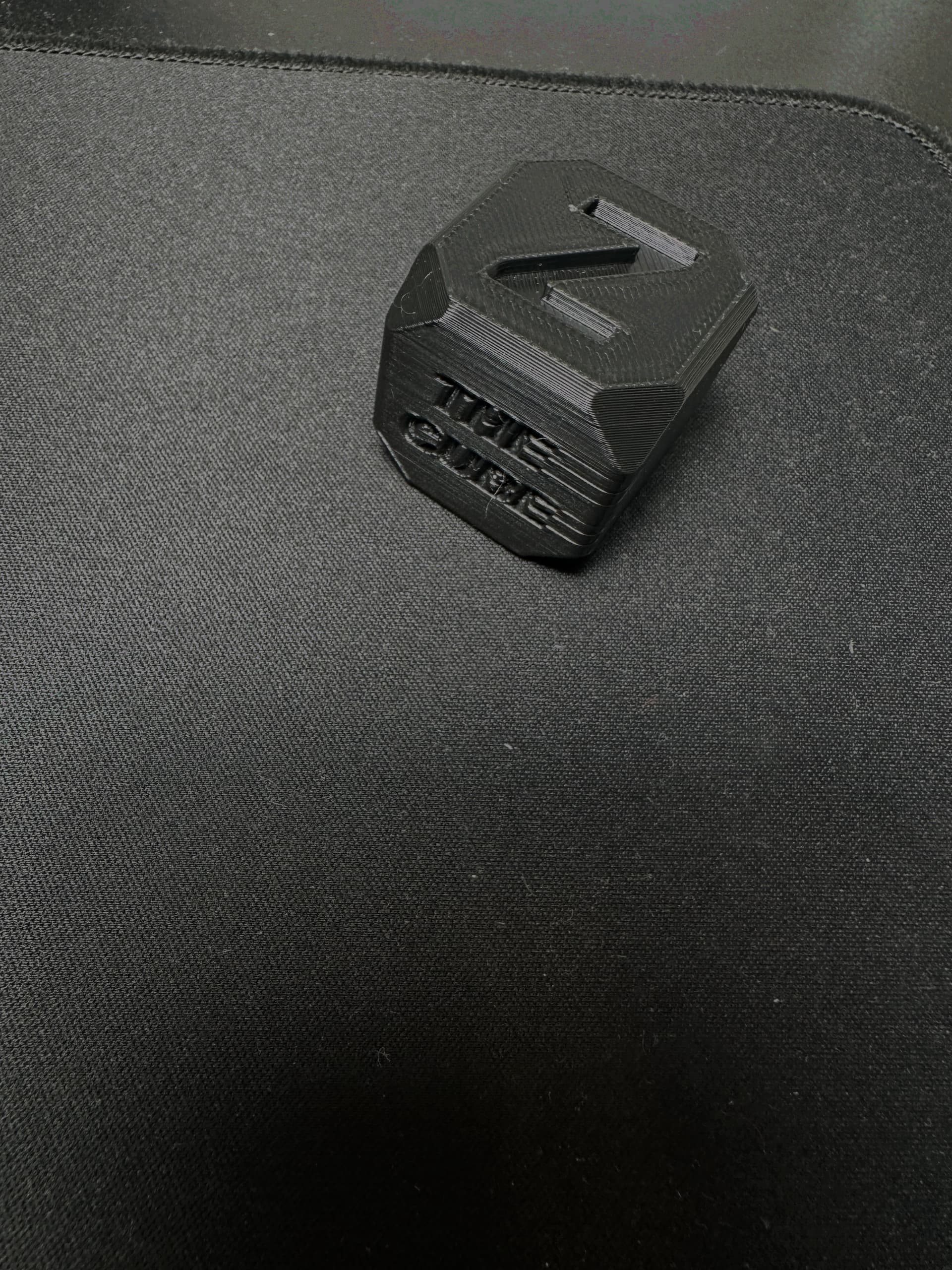

Hi everyone,
Did anyone actually manage to solve this? I’m having the same quality issues with my new P2S, and it’s beyond frustrating.
I’ve already tried re-tensioning the belts and checking the hardware, but it didn’t help. Right next to this machine, I have an X1C with over 3,000+ printing hours, and it still produces significantly better results than the brand-new P2S.
It’s hard to accept that a next-gen printer is being outperformed by an old workhorse right out of the box. Is this a widespread quality control issue with the P2S series, or is there some other hardware fix we’re missing? Would love to hear if anyone found a real solution
In the same boat, coming off an a1 mini for the past 6 months did a side by side print with same filament and settings, z banding is worse on the p2s doing a tall cylander.

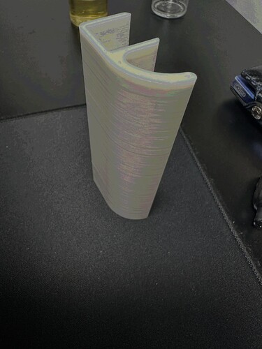

A couple weeks ago I printed a sleeve for this puzzle model on Makerworld, and it came out PERFECT. Like I couldn’t even tell it was 3D printed it was so good. I have no clue why it was so good, I’m assuming it’s the consistent layer times and extrusion rate but it was like actually so good looking. I can’t take pictures of it right now but maybe later I can. So I know the P2S is capable of printing really good, but something is just… off.
