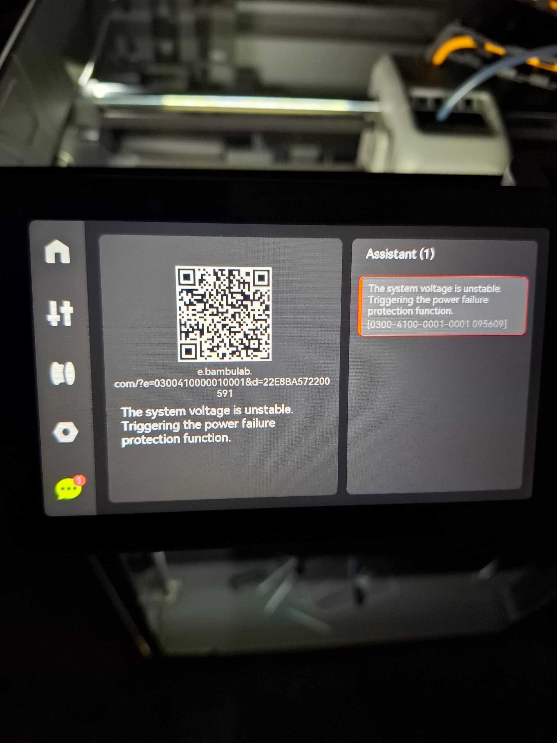

I was just printing some TPU parts when all of a sudden mid print the P2S restarted. While doing so, every other electrical device, connected to the same power breaker went dark for the fraction of a second and came back on. Same with the printer itself.
The powerbreaker does not trip.
This repeated itself 3 more times.
To be clear: 230V, combined power of devices on that breaker line ~ 1300Watts with the printer mid print. (Germany, rated to ~3600Watts per breakerline, depending)
After restart, the printer gave me:
HMS 0300-4100-0001-0001 095609
“The seytem voltage is unstable. Triggering the power failure protection function.”

Okay, problem solved. The issue came from a faulty wifi-socket.
