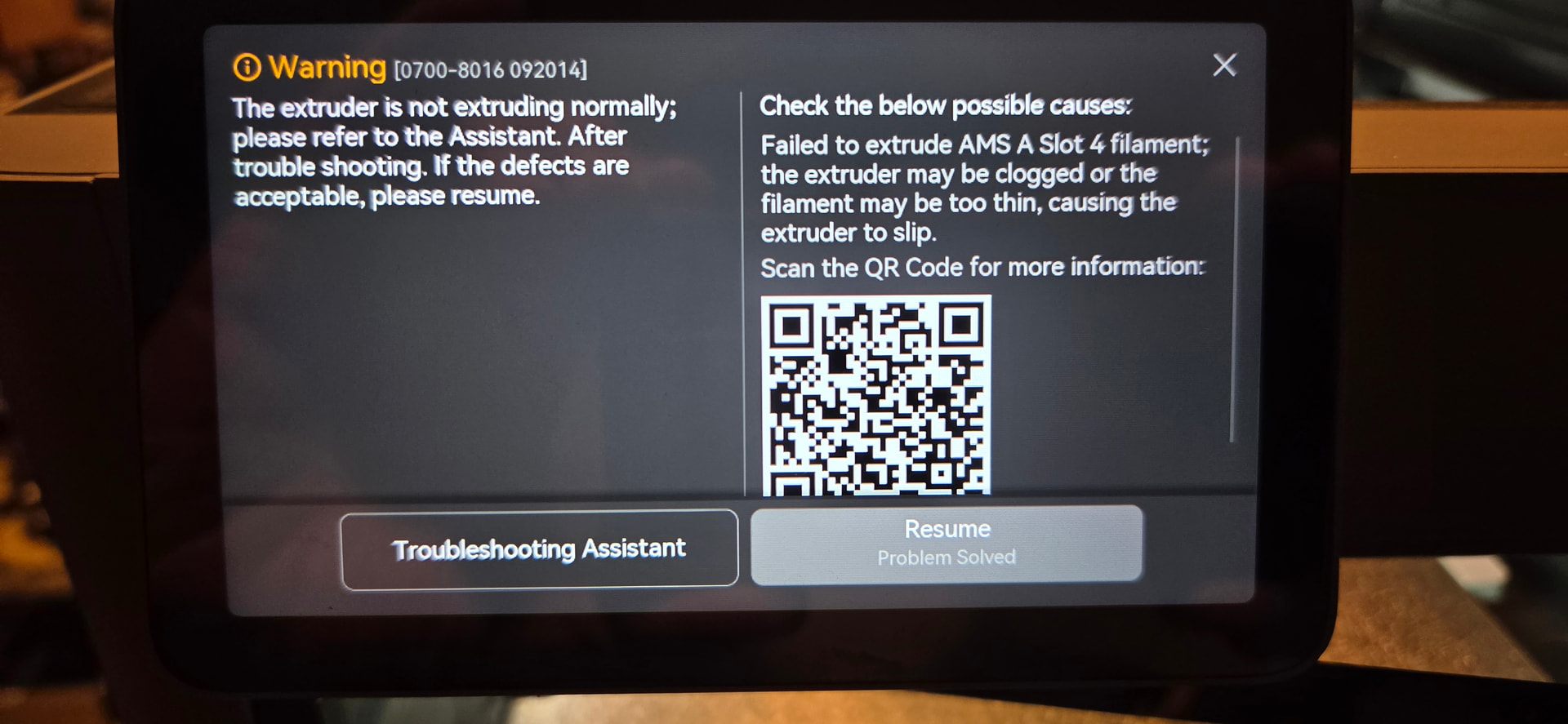

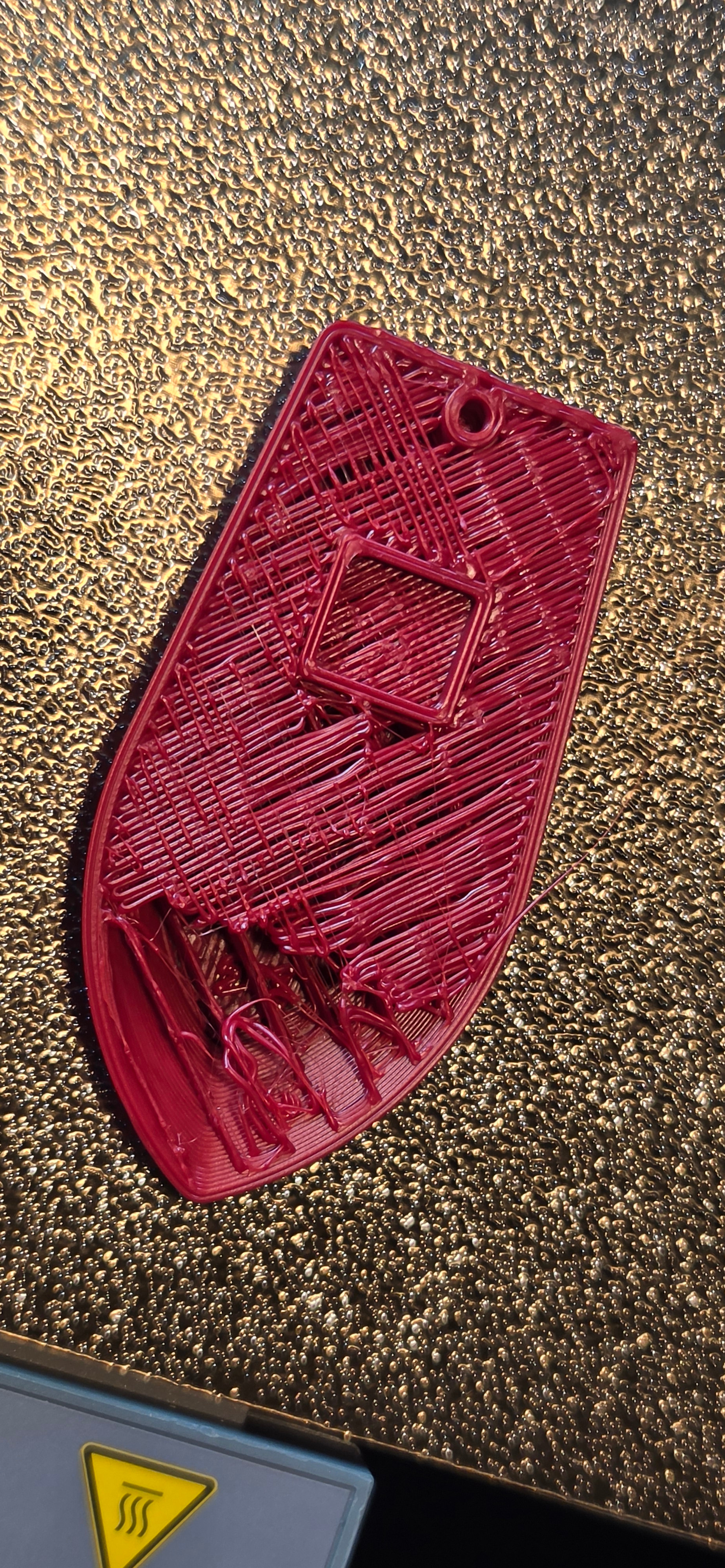

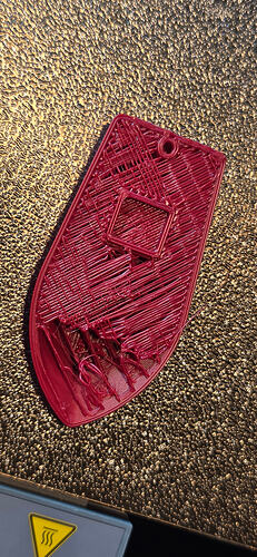

I am trying to trouble shoot an issue with no suggess on my P2S with the AMS Pro 2. I am only prining with Bambu PLA. All of the sudden it isn’t printing correctly. I can load, unload, and extruder filament using the menu, with no problem. I can also heat the extruder, via the menu section, and manually push filament through the extruder. I have taken the extruder apart and cleaned it. There never was a clog, and the gears look fine to me, even under close inspection. When I try to do a test print, it goes through all the typical procedures. Once it starts the Benchy test print, the print starts way over to the right side of the build plate, which I’ve never seen happen before. It seems to start printing fine, but have a few layers I get a clicking sound from the extruder. To me, it seems like the gear is slipping. It moves slowly, extruding filament, then all of the sudden the gear RPM goes way up, and seems erratic. I have to idea what the issue is, but I suspect it must be the extruder motor. I have never tried to tighten or loosing the tension screw on the extruder, and don’t know what it would all of the sudden change. I should mention that this happens regardless of which filament spool I use. Now that I have the extruder tension mechnism removed, I have no clue how to put it back together, and expically how to set the tension correctly. I have file a technical ticket with Bambu, but we seem to be going back and forth instead of addressing what the issue is. It seems like it just an automated responds system. Obvisouly I would like to get my P2S up and running again, since this happened 2 weeks ago.

PS: I should also add; I disconnected the AMS, but I only unplugged it. I did not reroute any of the existing PTFE tube I unloaded the filament that the AMS had loaded. Then I shut off the P2S. I mounted a Bambu PLA spool on the external holder, and fed the PLA by hand until it reached the extruder. I energized the P2S, and loaded the external spool. I then tried a test print, and the same clicking/slipping issue is happening. It will start the print but as you can clearly see it is not printing correctly. Eventually the print errors out. I have attached a video of the slipping that occurred. You can visually see the gear slipping from the increased RPM

This is most likely a partial or full nozzle clog. You should have gotten a small needle with your printer. Heat the nozzle to 250 degrees, and then move the needle up and down through the nozzle, then try again
Can you explain why I would have a clog in the hot end, when I can unload, load filament, and then extrude filament when pressing the extrude button, even if I press the extrude button many times? I have also removed the PTFE tube, headed the nozzle to 240, and manually pushed several inches of PLA filament into the extruder.

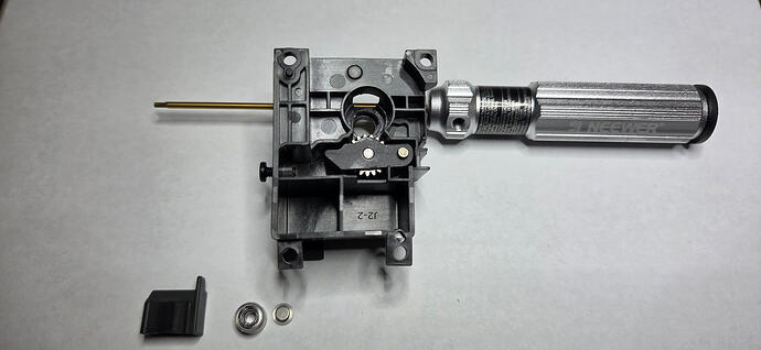

I have figured out how to assemble and tighten the tension block, so that is no longer an issue. As I said before, I do not have a clog.
1. I have completely disassembled and cleaned the extruder. There was nothing clogged or filament fragments.

That sounds less like the gear randomly slipping and more like the extruder is skipping because it is meeting too much resistance somewhere. In other words, the filament may not be fully blocked, but something is making it harder to push through during an actual print.

That can still happen with a partial clog, nozzle restriction, or the nozzle/hotend not being seated fully. Loading/extruding from the menu is slow and controlled. A print demands more consistent flow, more retractions, and more pressure, so a partial restriction or slightly loose/improperly seated nozzle may only show up once the print starts. This is also a very common sign of a defective nozzle. Just to be sure can you just go over everything a get a bunch of good photos.
Where I would start:
I would confirm the nozzle/hotend is installed properly and locked in securely. You would be surprised how often that ends up being the issue.
After that, I would run the built-in nozzle cleaning/cold pull routine from the printer screen (use PLA to clear the ABS option). I would run it twice to make sure there is not a partial restriction left in the nozzle.
Alternatively, if you have another nozzle/hotend available, I would swap it in next. That would be one of the fastest ways to rule out a defective nozzle.
Since the extruder/tension mechanism has already been taken apart, I would also re-run the full printer calibration with everything back together.
Then I would send a fresh Benchy from Bambu Studio on your computer, not from the app and not from the printer’s built-in file. Make sure it is sliced with the correct P2S printer profile and the correct Bambu PLA filament profile and its placed in center or wherever you want. (if this still prints elsewhere lmk)
If it still clicks or starts under-extruding, pause it after the first layer or early into the second layer and post clear photos of the first layer, the installed nozzle/hotend, the extruder gears, the tension mechanism, the PTFE connection, and the filament path.

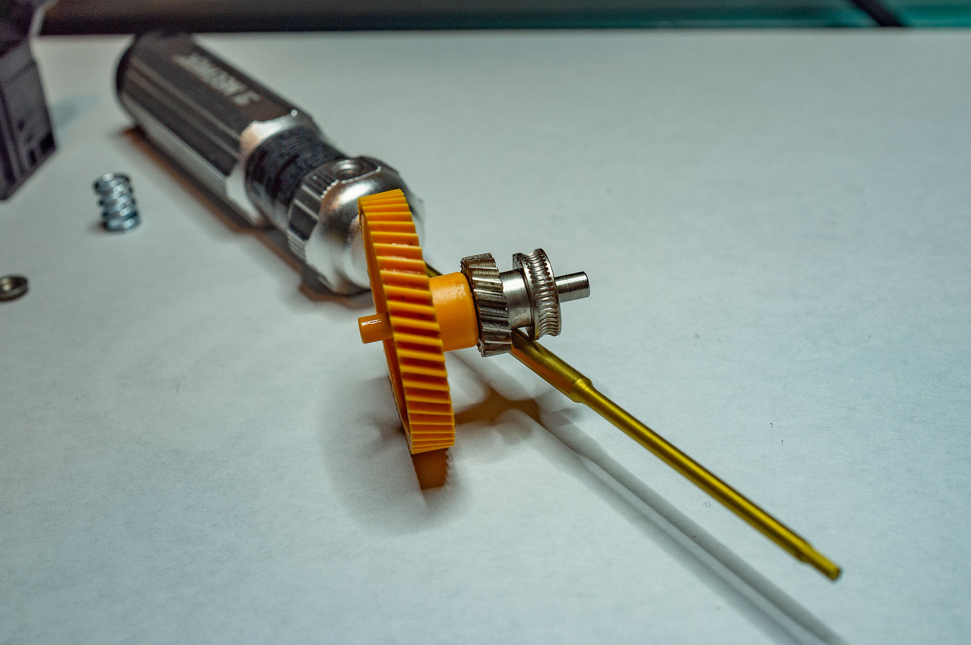

at this point, I would inspect the yellow extruder gear to see if it has any messed up looking teeth where it could be catching. otherwise, you could have a bad extruder motor.

Looks like you didn’t view one of my photos. I took a tooth brush to all of the gears. They are all clean, and no damage to any of the teeth. The bearing truns smoothly. I can here is spin when I used compressed air on it.

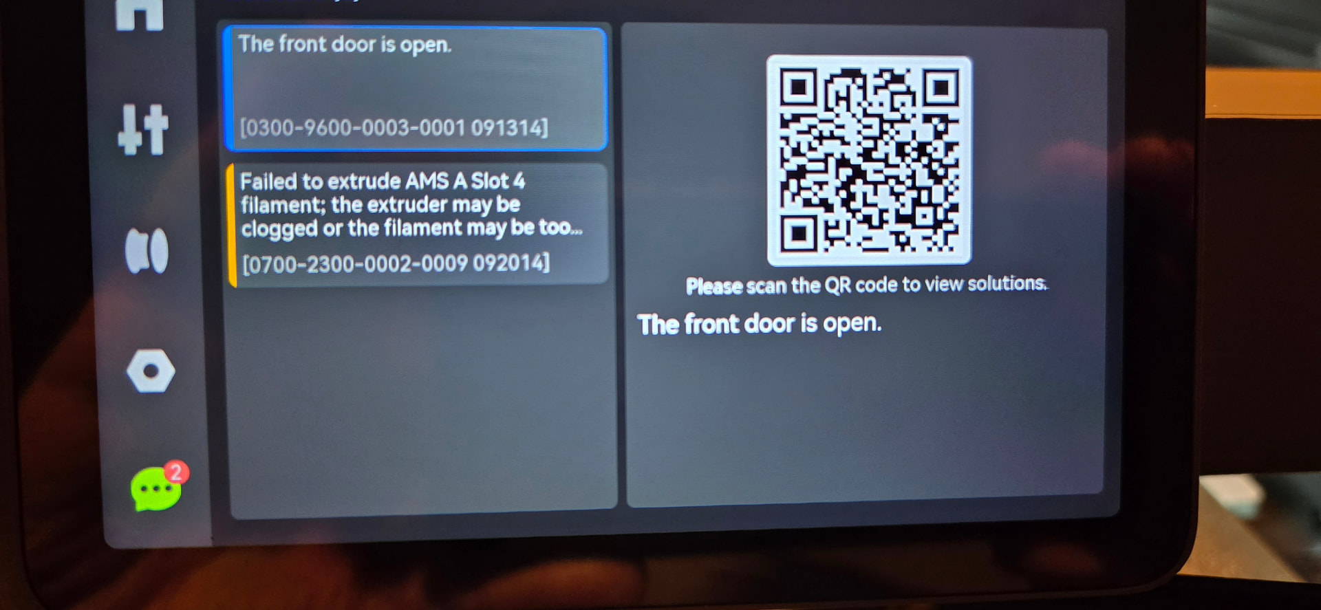

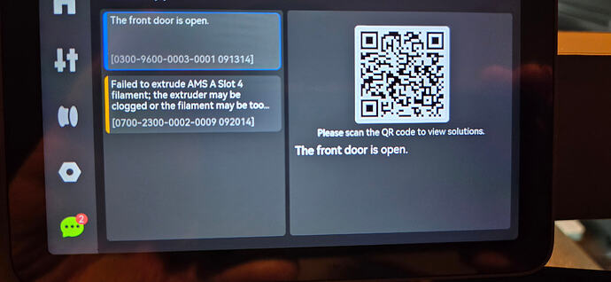

I’m still not getting anywhere with technical support. I’m sure I’m dealing with AI answers. I just noticed something that could be the issue. It’s sort of odd too. At the moment, my P2S is idle, but plugged in. If I go to the spool in slot one, I can’t easily rotate it by hand. If I go to the other three, they all move freely. I haven’t a clue why it’s stuck. I’ve also seen this happen on two of the other spool slots, when the machine is idle. I have no idea why or how the rollers may be ‘stuck’ and preventing the spool from rotating.
I am totally lost to what the problems might be, nor how to solve them. It’s pretty obvious if the rollers are the issue, therefore keeping the gears from pulling from the spool, it would make the gears slip. Has anyone ran into this issue before?
