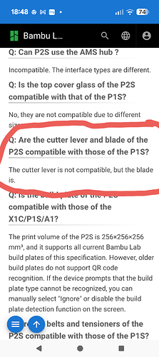

They LOOK the same in the Wiki as the cutters for the X1 Series/P1 Series/A1 Series/H2S, but I think I would ask Support before ordering.
They do. It’s odd though that the actual filament cutters list every machine but the P2S. The cutting lever says it comes with one but doesn’t show it.
It’s odd. I agree, support will give the definitive answer, and I’d like to know.

I’ve researched this further and apparently you can use the H2S blade which is identical,the only difference is you can’t use the H2S cutter lever arm as they are designed differently,but blade size and fitment are the same.
This sounds strange, because looking at the store: Replacement Filament Cutter | Bambu Lab US Store
the H2S cutter is the same as P1S. So still unsolved…

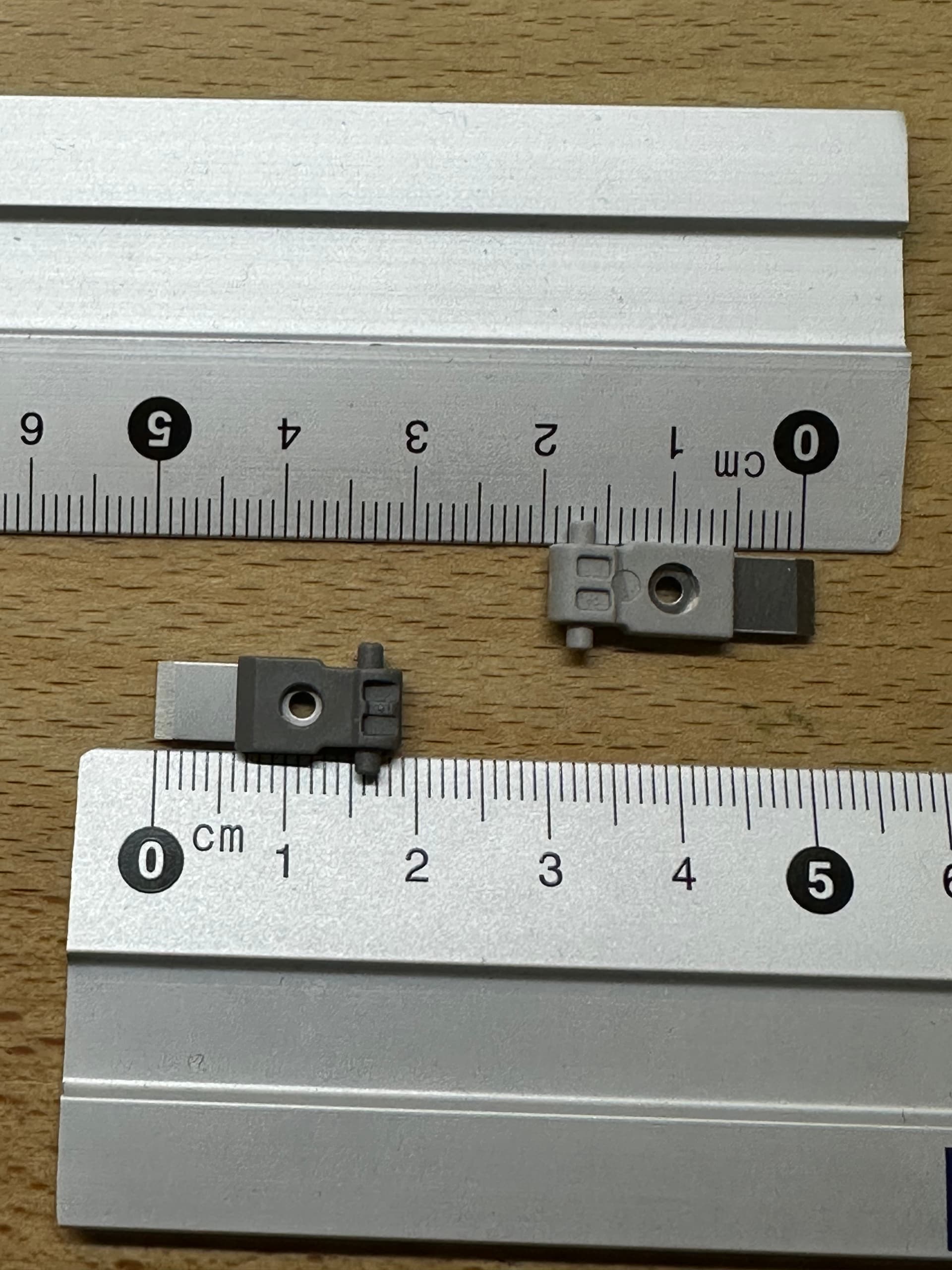

So, here’s a 1:1:
Upper: A1/P1x/X1
Lower: P2S
Sorry, no crazy dimension units… :laughing:
