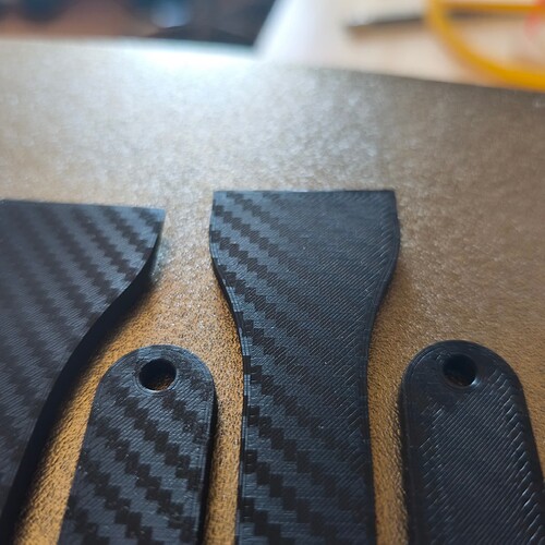

I’m having an issue with the first layer on the P2S. I’m a keychain manufacturer, and this printer was supposed to improve my production workflow — unfortunately, the only truly reliable printer I still have is the A1.

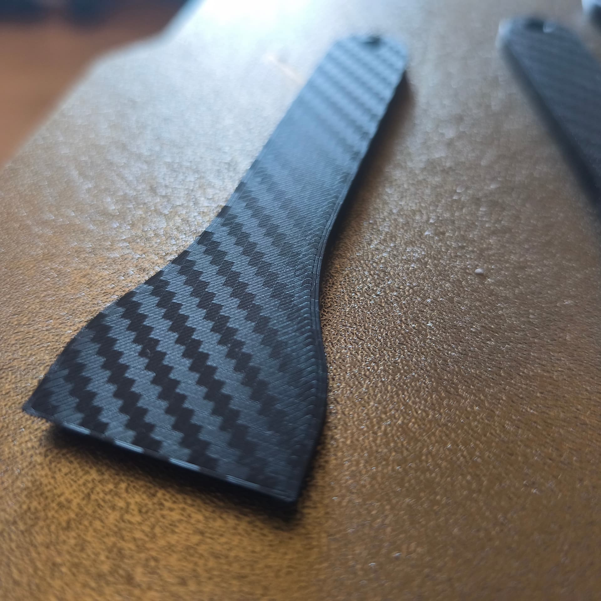

The problem is visible lines on the first layer that “shine” when viewed from different angles. I’m printing with a 0.2 mm nozzle. I’ve attached comparison photos of the first layer printed on the A1 and on the P2S.
On the P2S, there’s also a clear difference between the outer lines and the infill, while the first layer on the A1 is perfectly smooth and uniform.
The issue occurs mainly on the Carbon Plate, but it is also visible on the Textured PEI Plate, just slightly less pronounced.

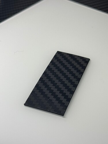

I had acceptable results on my P2S with the carbon plate so far. Have a look at the special carbon effect print profile on my model here, and tell us how it goes? (We can go further and tweak the temperatures)
Hi, your model is designed for a 0.4 mm nozzle, so this effect may be less visible. However, looking through the replies to the model, I found one photo where another user’s carbon effect looks just as weak (see the attached image).
As for your first question - I tried to recreate the settings from the A1 (which works almost on a stock profile, except for ironing) on the P2S, but the result is still not satisfactory. I have the impression that this is a slicer issue in P2S, because it’s hard to believe that a printer that is technologically much more advanced than the A1 would produce such a poor effect.
Could you share the photos? It would be good to show in this thread that these issues are not happening only to me.
Yes, I also tried to adjust it, but the lines are still visible.
Sorry, I did not see you have issues with the 0.2 nozzle specifically.
I do not know what settings the other users have, in my case the picture from the model have been made with the proposed print profile, Black PETG if I remember well, and a 0.4 nozzle that’s right.

Yeah Hilbert Curve is the best solution for this so far, but still - A1 with monotonic lines works perfect, but P2S not and that is the problem… However, thank you for your active involvement in trying to solve the problem!!

I think I may have found the solution to the problem of bad adhesion. It seems that the factory Z-offset setting on the P2S is absurdly too high. For the P2S it’s set to 0.01, while for almost every other printer it’s around -0.04.
During my tests, this value initially seemed far too low to be usable - but apparently not. The print now adheres to the build plate very well. However, the issue with the shiny silver lines has not completely disappeared, although using Hilbert curves for the bottom surface significantly reduces the effect (at the cost of longer print times).
