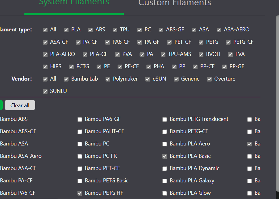

Welcome to the forum!
Make sure they are added in the filament section:
There are some Polymaker profiles built in.

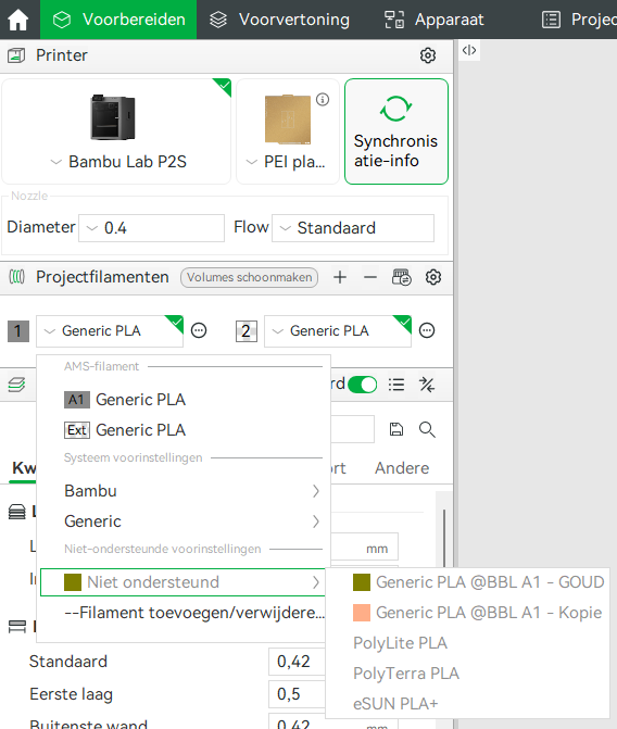

Thank you for replying.
The “other” filament brands are stored under non-supported filament, and can not be opened on the P2S.
(They do work on my A1)
