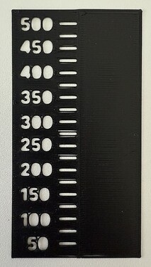

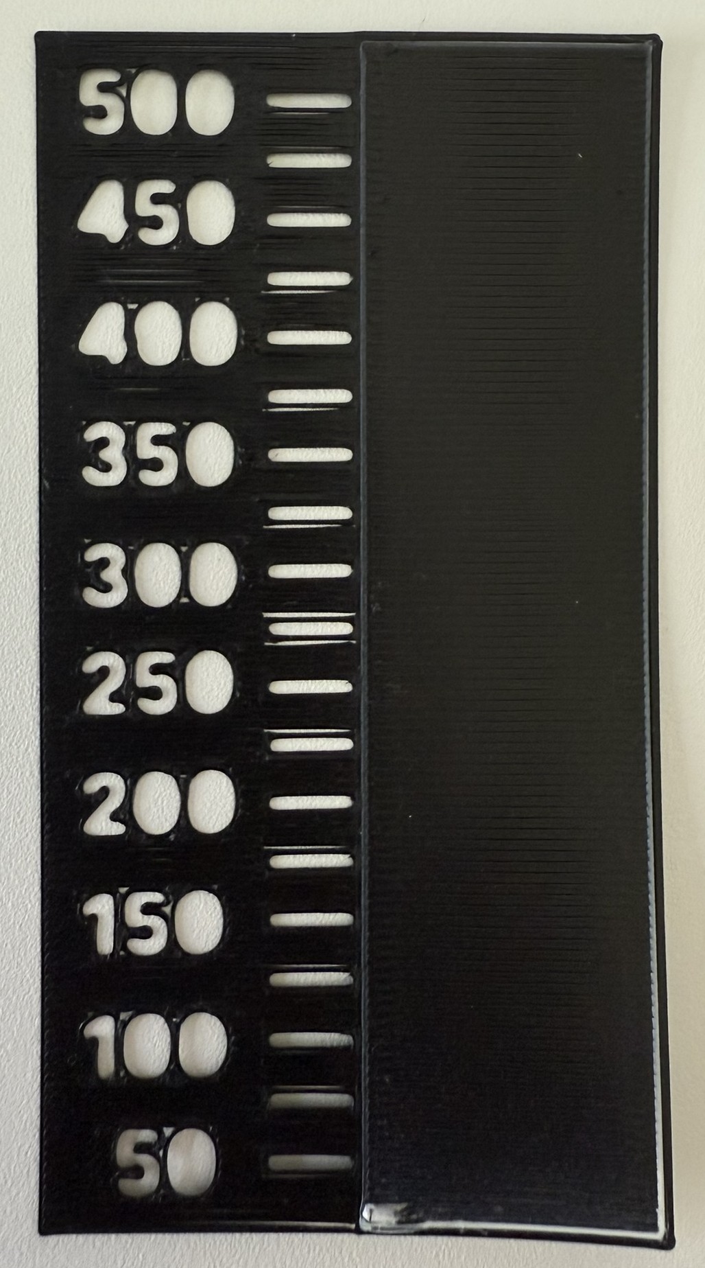

Hello everyone, I’ve gone down a brain-breaking rabbit hole upon discovering (thanks to failing a purge calibration model) that the P2S has “optimised” default G-code that mandates an 𝑥 amount of flushed filament on every print start up & filament change. This results in a failed calibration gauge as the printer poops the material intended for the model:
I have the P2S Combo & this occurs even when Project Filament > Flushing Volumes are set to ‘0’. I’ve successfully tested a fix for the purge on P2S start (Step 2) when using the same filament across prints, but I also want to eliminate purging for filament changes so that everything is flushed into the calibration model & I can put them all in a neat lil’ tray.
I know that the G-code responsible for this flushing process is located in: Bambu Studio > Printer Settings > Machine gcode > Change filament G-code. My problem is that the P2S flushing G-code on filament change is different from P1S/other models. Any solution for reducing filament waste does not address these purges.
I’ve seen other users who end up stuck at this step. If I had to guess, it may be executing between; VFLUSH_START to ; VFLUSH_END:

It’s sooooo stupid. Turn off auto calculate purge in settings. There’s 3 options, auto, color change, off. What it’s SUPPOSED to do is just calculate the purge numbers for you, like when you change a filament it’ll auto calculate it. But for some reason with it on, it ignores the values when set to 0. Not sure if it ignores all the values, but for sure it will ignore low values (I tired 0-10mm3 before figuring this out)
