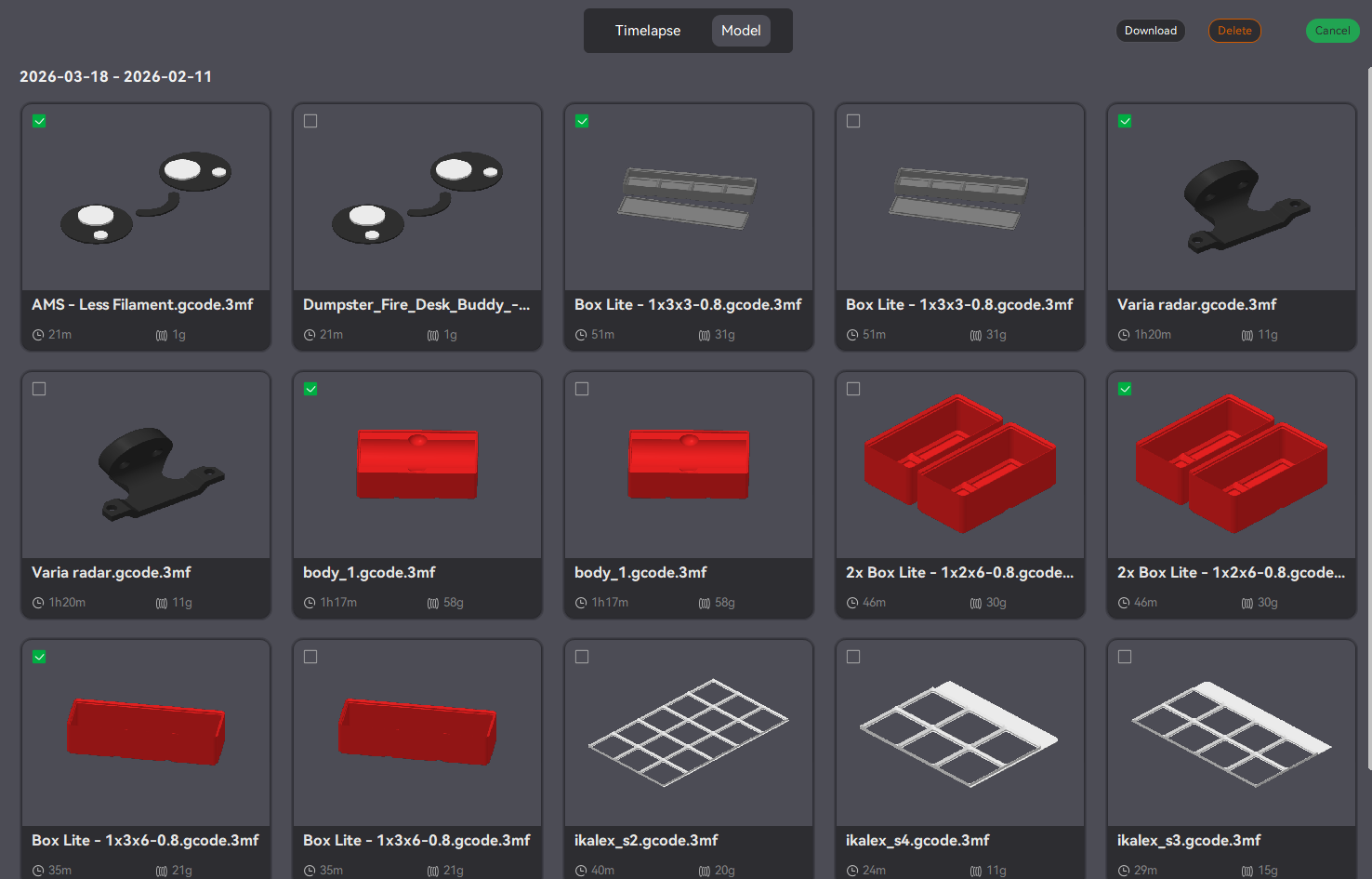

P2S: Insufficient system memory + poor USB file management
I just want to say I love my P2S - it’s a great upgrade from my P1S but…. it feels like we’re lacking a lot of support/bugfixes
This issue has been raised many times on here, reddit, github etc… with no replies
A restart of the printer seems to solve it for a few days but this needs better handling

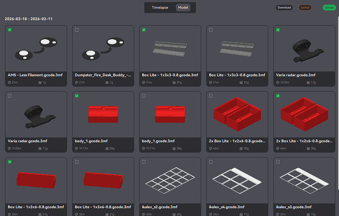

I am also still confused why all models on USB are duplicated?
Every time I print something I have to go into the UI and delete one of the duplicate models

Does the usb need formatting with the printer ?
P2S Offline Firmware Update Guide | Bambu Lab Wiki
Yeah my USB is 256gb - there’s virtually nothing on it. A few model files and no timelapses
